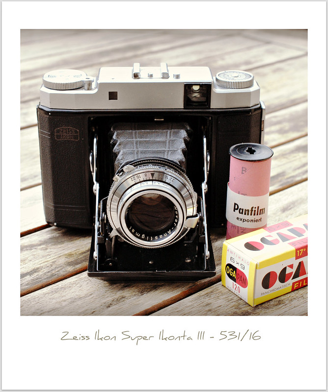

Another vote for the Super Ikonta series cameras. I use a Zeiss Ikon Super Ikonta III 531/16 with Novar Anastigmat f/3.5 75mm - price was 130,- EURO (the Tessar line is more expensive).
Like it a lot.
Super Ikonta III - 531/16 by Andreas, on Flickr

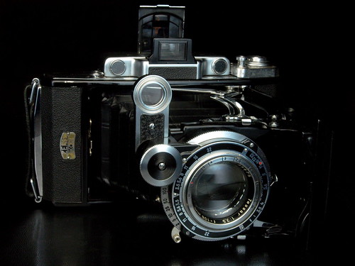

I'm going to play devil's advocate here and suggest you look at the Moskva 2.
When one considers how the old medium format folders were constructed, there is virtually no difference between a German and a Soviet folder.
The Moskva 2 is a Super Ikonta in everything but name. Solid, reliable and prone to exactly the same pitfalls as the camera it copies.
The lenses are also extremely sharp. The only thing the Moskva lacks is the higher price tag.
The only caveat is that you should only EVER buy former Soviet cameras from a reputable dealer, but given their age, that will be true of any MF folder at this point.
