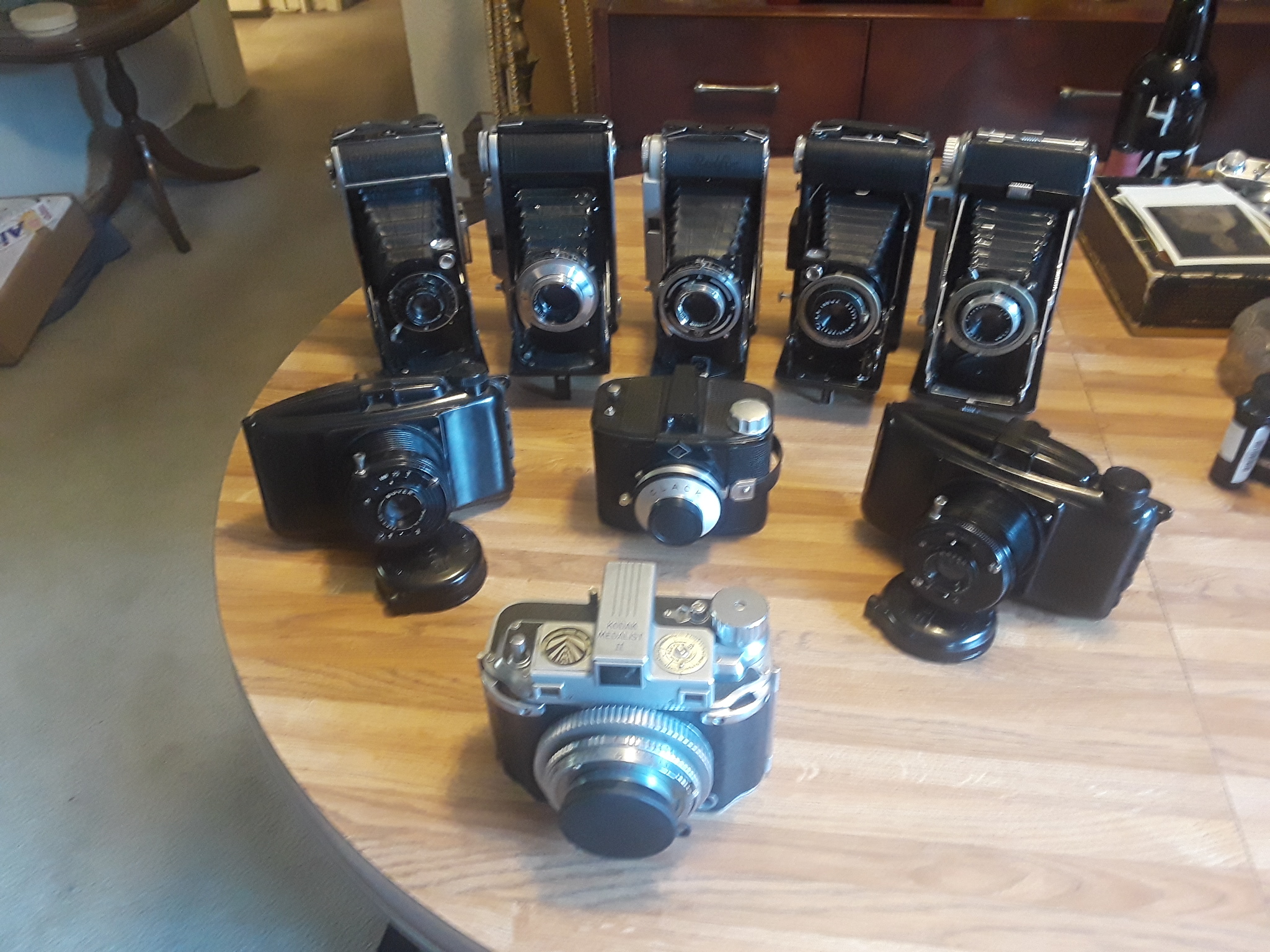

Pick one.

thuggins, what's the dinky looking camera right behind the Medalist?
