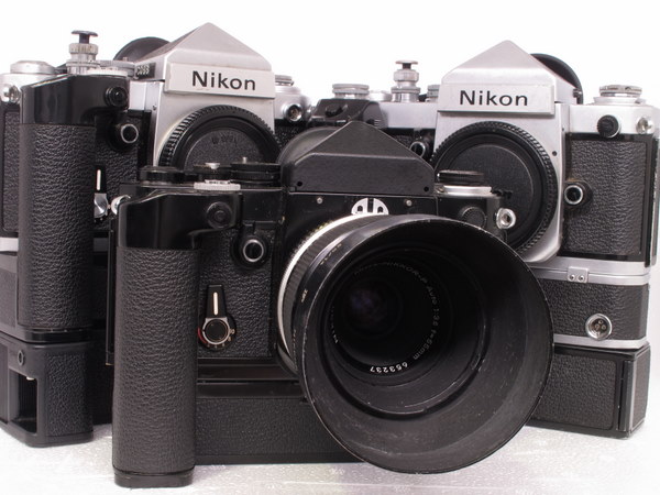

When I was shooting macro and copy work, 100% viewfinder coverage was very important to me. The Nikon F, F2, F3, and F4 that I used all had viewfinders that provided the 100% coverage that I needed. Of the four, the F and F2 were mechanical.
http://www.flickr.com/photos/11336821@N00/6307637714/
