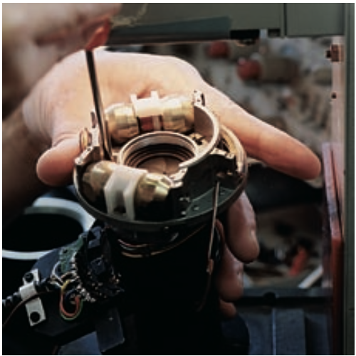

Exactly, the Rolllei shutter has no mainspring and does not need to be cocked. The leaves of both the shutter and diaphragm move via electric motors.
The archetype 35mm electronic shutter mechanically releases the first curtain via the mirror movement upward, and releases the second curtain via electromagnet.
However, what is described in this thread, is the continued inclusion of the mechanical escapement. Not unreasonable since the electromagnet can be made smaller than a mechanical escapement. So you can have both without making the camera much bigger.

In my mind, mirror and aperture movements done by motors seems simple enough but I have no idea how a motor can close the shutter that quickly with precision! I wonder how they spin up the motor that quickly as well as decelerate it? Working on electronic pinball machines, I can almost conceptualize using a solenoid but not motors!
I think they are more like a solenoid but they call them "linear motors" in the literature. I have a treasure trove of Rollei repair documents, but nothing on those lenses.
