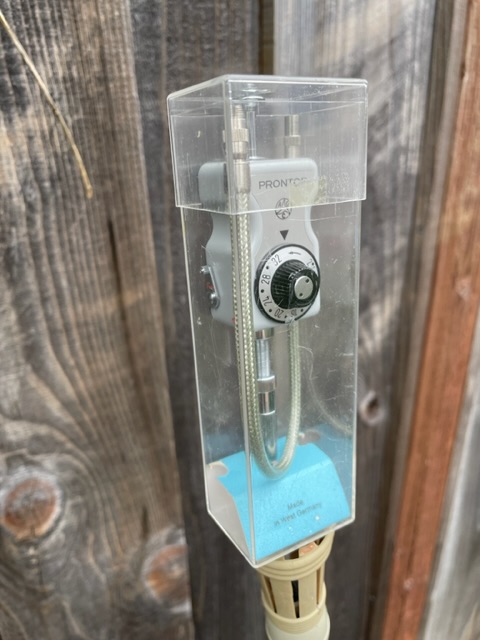

Get one of these for 2 - 32 seconds. It has a T selector too.
Bill Burk
Feb 9, 2010
9,154
from 2 to 32 sec I can do it in B and a watch. At the 2 sec speed I think I can do a 5 to 10% accuracy. At the 32 seconds. I can surely do better than 1%
Any time I might need this gizmo I am just as likely to need 30 minutes. So it sees little use.
