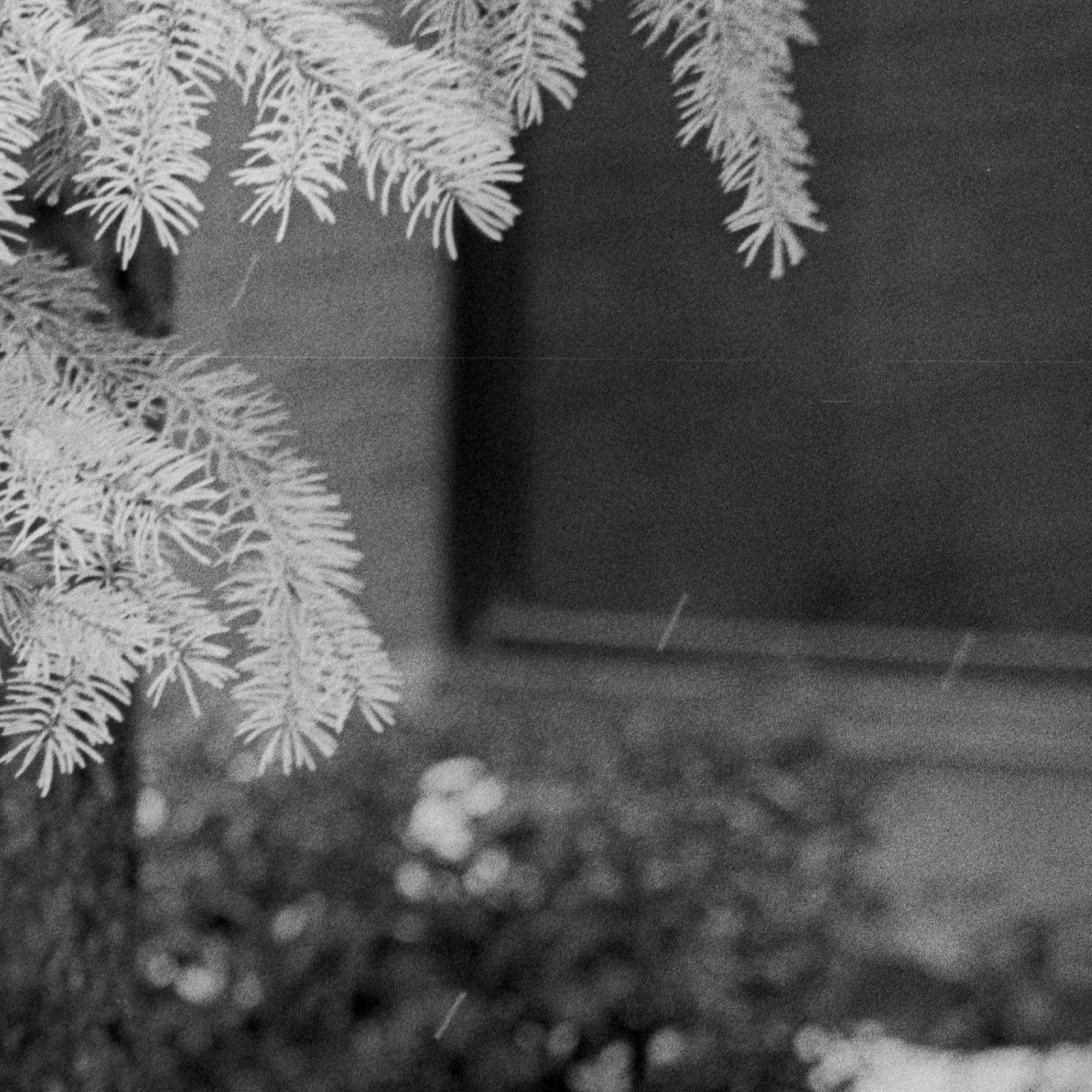

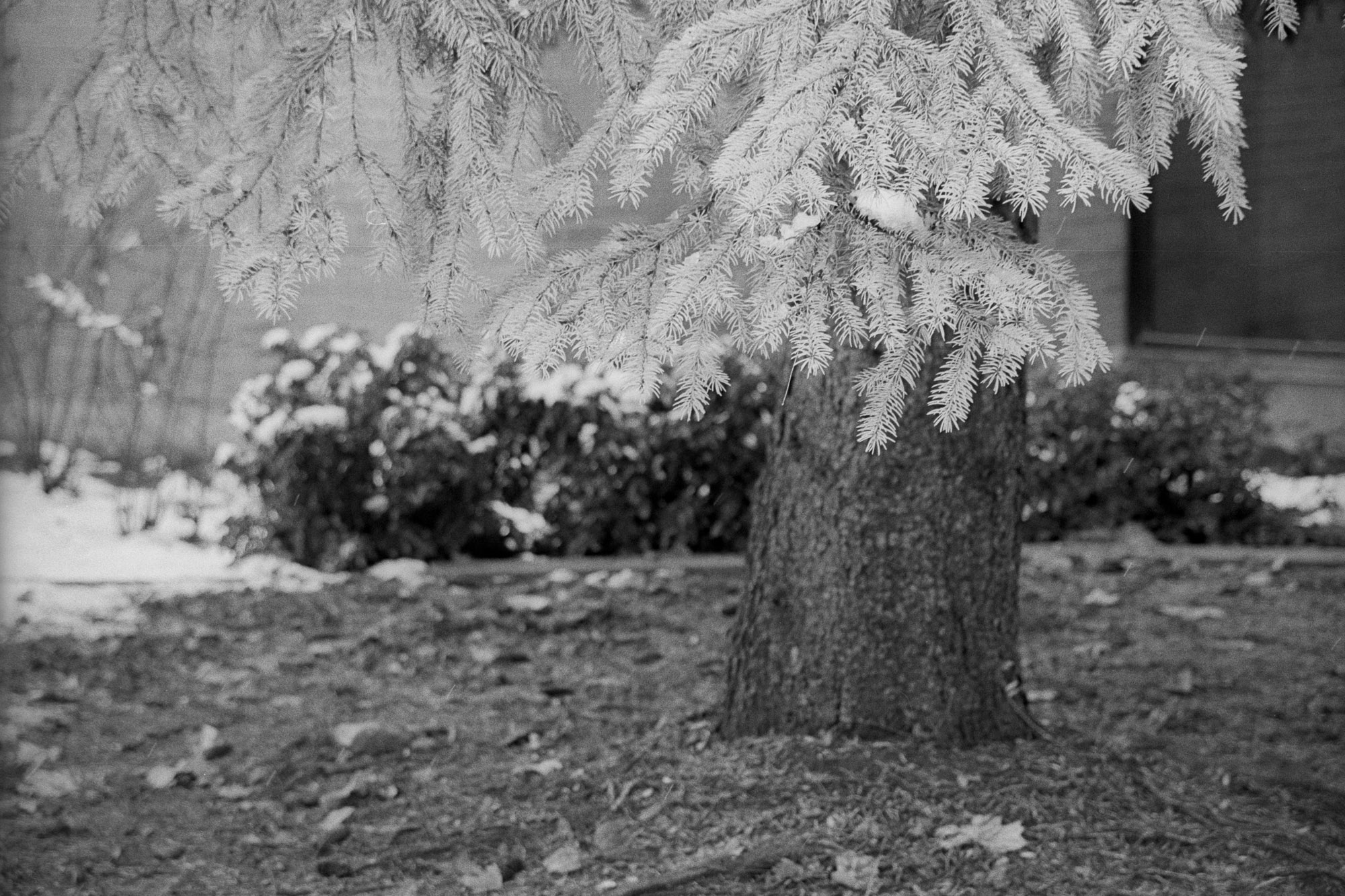

HP5+ @ EI 400 in Mytol Stock with 100% crop:

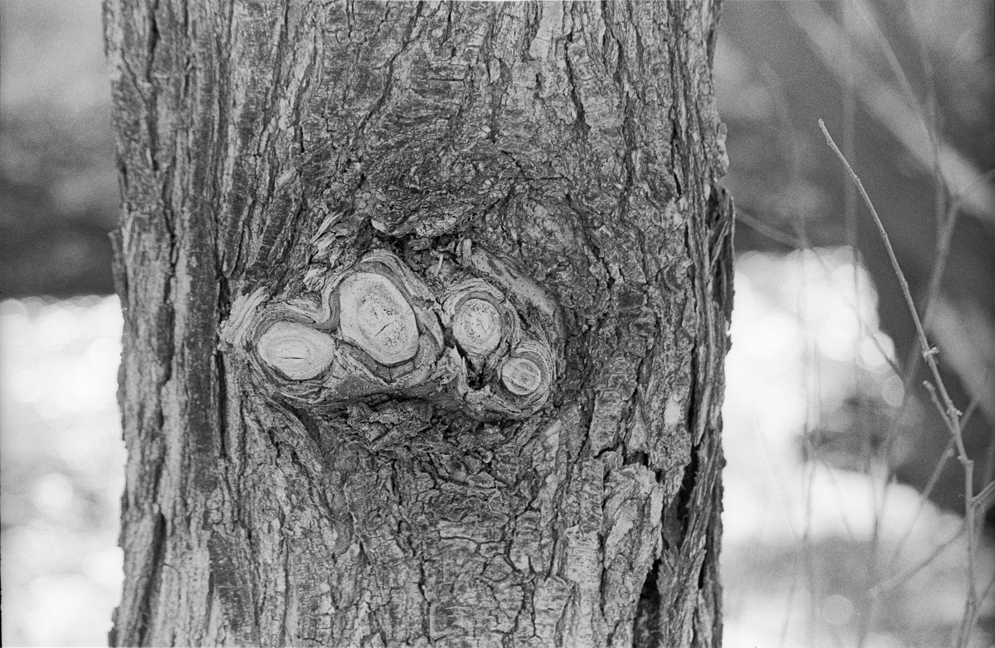

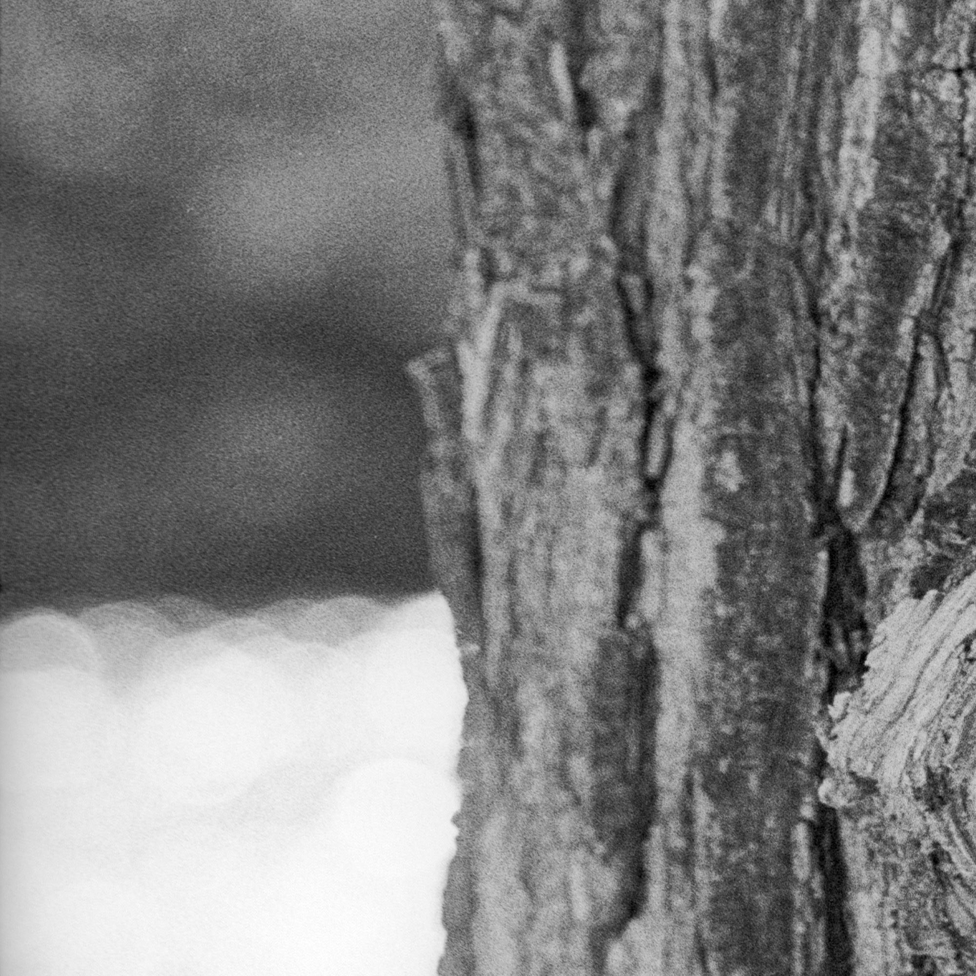

HP5+ @ EI 500 in Mytol 1:1 with 100% crop:
I am surprised, that HP5+ in a 4000dpi scan looks no grainier than that. Are you 100% sure, that your scanner software didn't perform some magic here? A 4000dpi scan like that would give you a decent 13x enlargement, probably more, and HP5+ is not known to do that well.
I don't usually scan my negatives, so I couldn't tell you much other than that I'm using a Nikon Coolscan 4000 with Vuescan, I've turned off all the automatic stuff like grain reduction or JPG processing or profiles, and... well, Mytol has been pretty impressive stuff so far. There's definitely more grain in the HP5+ scans than my FP4+ ones (unsurprisingly).
That said, when I do want to digitize something I shot on B&W film, I will usually make an 8x10 silver gelatin print, and scan that on my flatbed. Seems like much less room for error in the scan that way, and it's much easier to get it to look on the screen the way it looks on the paper. And when I do this, the grain is sharper than when I scan the negative. So the Coolscan optical system is imperfect, and probably masking some amount of grain, even at 4000 DPI.
