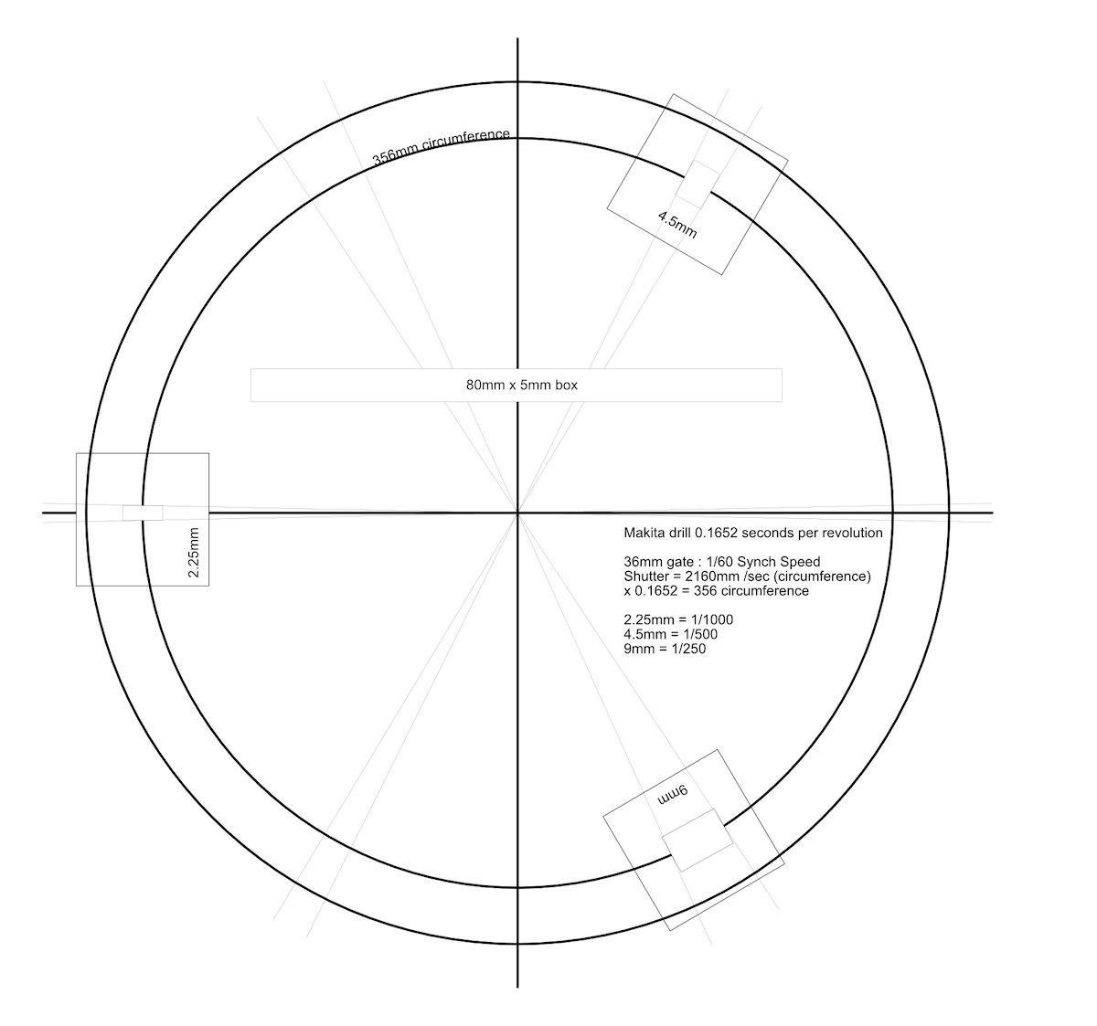

Very interesting! That's what was missing from this whole debate. A seemingly simple and precise device to check the measuring equipment.
How is the disc driven? It has to be speed-controlled, right? How did you calibrate it?
A common drill spins the wheel. Math was used to calculate the circumfrence at which the velocity was the same velocity as the focal plane shutter. The slits were made 'pie-shaped' with projection slide cropping tape, like a cine camera focal plane shutter, so that if the measuring point was not exactly at the 'correct' circumference, the shutter speed will not change.
The RPM of the drill was measured by attaching a flag to the drill and measuring the time for ten spikes on the screen and dividing by ten.
During the test recordings of the waveforms, the drill speed was double checked, again measuring the time for ten revolutions and dividing by ten.
Nominal speeds are printed on the wheel, but to be exact this wheel shown gives 1/240, 1/480, 1/960 because the cameras I was testing synch at 1/60 (not 1/64) and then half the frame distance with each increment in shutter speed.
But for testing a shutter tester you can make the slits any width and any RPM as long as you know the slit width and RPM you can calculate the rest.

Thank you for the instructions. Great!
I will definitely recreate this. It is good practice to first verify the measurement setup before starting measurements.

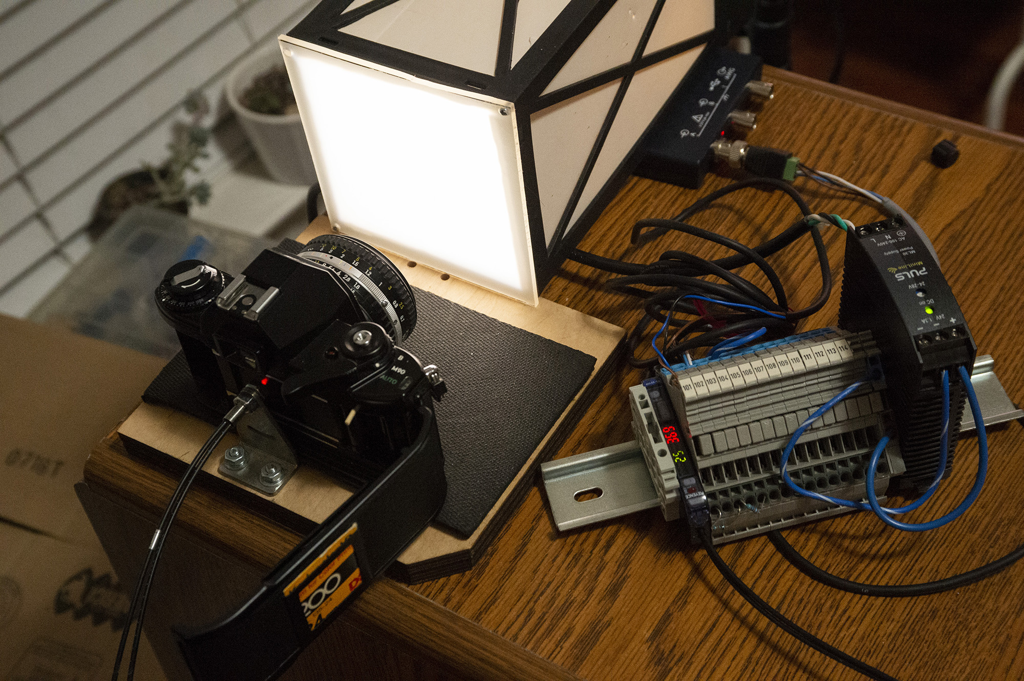

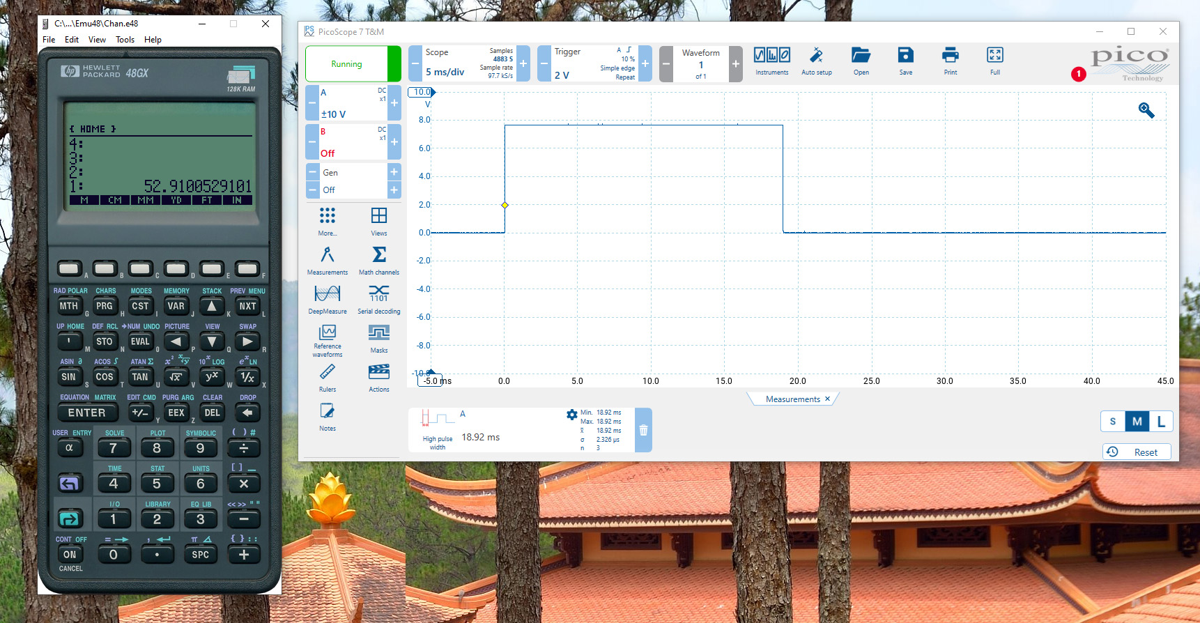

I use a variable light source. At the moment the light source is LV12. The aperture of the camera is set at f/8 and the shutter speed indication in the viewfinder is 1/30 (ASA100) thus the indicated shutter speed is low. Now with the sensor reading the shutter curtain and feed the signal into an USB based oscilloscope I have the pulse width is 18.92 milliseconds or 1/53 of a second. Which is close to the 1/60 speed that it's supposed to be. So the problem is the actually shutter speed is close to what is should be but the indication is low. So I have to adjust the galvanometer movement and not the signal feeding the shutter control circuit.

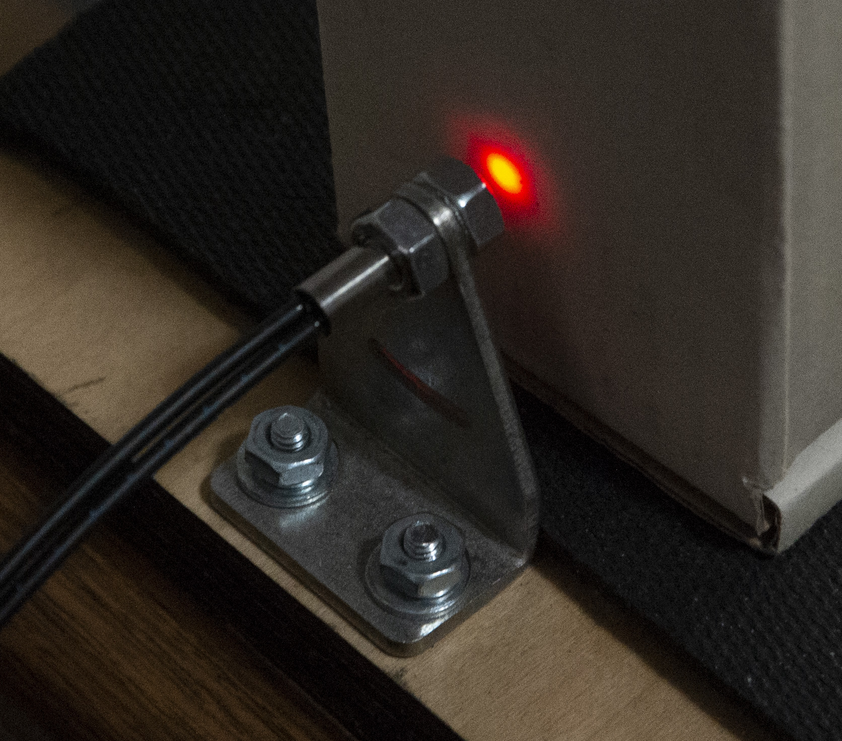

The sensor uses 2 fiber optic cable, one to shine a visible red light onto the target the other is feeding the light reflected back from the target and feed the amplifier.
Great idea. Did you make the cable? I need the same for my Minox tester.
No both the sensor and fiber optic cable are off the shelf item. I used them at work and they would cost something like $200-300 for the set but I bought them from Ebay from China for like $40 for the set. The fiber optic is Keyence FU-66 I paid $15 with free shipping. The sensor is Keyence FS-V31P and I paid $25 with free shipping. The only thing is that the response time is 30 microseconds which is just barely OK to check speed 1/2000 or so.
