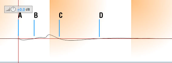

Measuring my Nizo Pro's shutter speeds. This one attached is a single frame taken at the 18fps setting and should hence be 1/43. Here is the output using a photodiode. I seem to have more peaks than is expected so not sure where I should take the start and end of the shutter opening time.
I'm using a a circuit like the one below (sans capacitor) and using a Bowens flood light. The photodiode is inside the camera body right behind the shutter gate. Recording to minidisc and opening in Soundbooth. And the PDF below also tells us how to measure the time from the wave form.
I've added an A, B, C and D to help identify the points I should be using.
Dead Link Removed

I think you would be better off using the capacitor, as it isolates the DC bias from the audio input. There is probably a capacitor in the audio interface but it is likely much larger and swamping some of the effects you're looking for. About two years ago I bought some parts to build one of those doohickeys but still haven't gotten around to it, it could be I really don't want to know! :blink:

The capacitor is there because audio input of a sound card cannot see DC. By putting a capacitor there, it will cut out all the DC component, and only the AC component, the change (such as a sudden rise in voltage when diode sees the light and NOT see the light) in voltage, will be apparent. In essence you are making a differentiation circuit. That's why the peak goes to the opposite direction - charge and discharge. No, it isn't charging THAT capacitor actually....
You should be seeing more changes though, even without a capacitor.

The little blips you should be seeing are a result of charging and discharging that capacitor.
