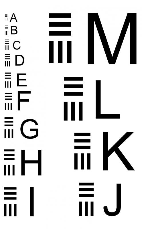

If you slide the detector and chart in opposite directions while keeping them in parallel planes, you will not distort the chart in the detector. The left and right sides of the resolution chart will indeed be at slightly different distances, which is perfectly normal in real life. If any uneven lighting across the detector is a problem, it can be corrected by uneven lighting of the chart. That will probably be unnecessary in any but the most critical tests, certainly not in testing pinhole diffraction.
. . . do you have a source for the graphs you posted? Fascinating.
I did the tests and graph posted above for a college project in pinhole photography in 1979. The film was panchromatic, the lighting was probably about 2800K incandescent. The improvised camera was donated to Pinhole Resource decades ago. The chart was hand-drawn, somewhat similar to the one below, and photo-reduced as necessary. As I recall, that chart omitted the letters to make it more compact. It is interesting to note that an optimum size pinhole can resolve line pairs with a spacing smaller than the pinhole diameter, contrary to what a few "experts" have claimed, apparently without doing the experiments.
