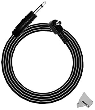

I recently bought a Mayima RB67 and want to sync it to my studio lights, but it is difficult to work out what cable to get... The one below is described as a "Kaiser 1301 Flash Shoe Adaptor with Sync Cable" - would that be the right type for my x socket on my lens?
You’ll need something like this for a studio strobe.
Welcome to Photrio.
The small PC ("Prontor-Compur") connector at one end of the Adaptor you linked to is the connection at the RB67 end.
The other end will depend on what your studio strobes use. The example Christopher linked to has a connector that many studio strobes use.
One further thing to be aware of - the RB67 lens shutters have quite robust synch circuits, that are designed to be able to handle flashes with relatively high synch voltages (and currents?). Some of the modern flash equipment, including radio triggers, use low synch voltages (and relatively low current?). If the contacts in the RB67 shutter's synch circuit are in need of cleaning or adjustment, you may have trouble triggering the radio trigger.
The coaxial PC sockets at lenses or cameras are of the female type. Thus you need a male PC plug, which is the more common one anyway. The adapter you show got such, but on the other end it got a "hot-shoe", meant for on-camera flashes. For studio flashes you need on the other end a plug that fits your studio flash, these connections vary.

The other obvious option (in case, for instance, the PC to Vivitar cord has been lost or damaged) would be a PC to hot shoe adapter that can then be mounted to either the camera's accessory shoe or the shoe on the left hand grip.
Thank you Donald, that is exactly what I have ordered.
