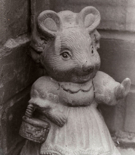

Hi, i seem to have a small prob,
I am shooting B&W and developing my own film and prints.
Included below is a print i made last week, it has a brown tint to it
Any ideas why this is ?
The Ilford developer was given to me and was told it may be off or going.
Maybe this is why. ( i know why the bubble shape lighter shade is there :wink: )

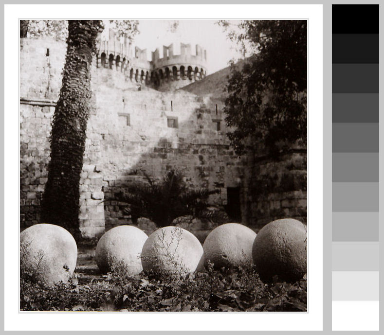

If it's a warmtone paper in a warm tone deveoper that's normal, if not it's hard to tell without more details.
Here's an example of a warm tone print against a neutral grey scale.
Ian

Here are my Chemicals,
the paper - Kentmere VC Select Fine Lustre Paper
Darkroom Chemicals
I did make a reply, but it hasn't shown up yet ?
I am using Ilford MG Developer and Ilford Stop Bath and Ilford Rapid Fix.
The Paper is kentmere VC Multigrade. The Film is Kentmere 400 (36exp)
So nothing as far as i am aware of is Warm Tone, all i could think of it the Dev is going off and
does have a slight brown tone in the gallon tub, when made up (1:9) its almost clear in the tray.
All of the pics i have printed have this brown tint.
There is no actual Black and white.

Here is the finished pic using HP5+ Negative
