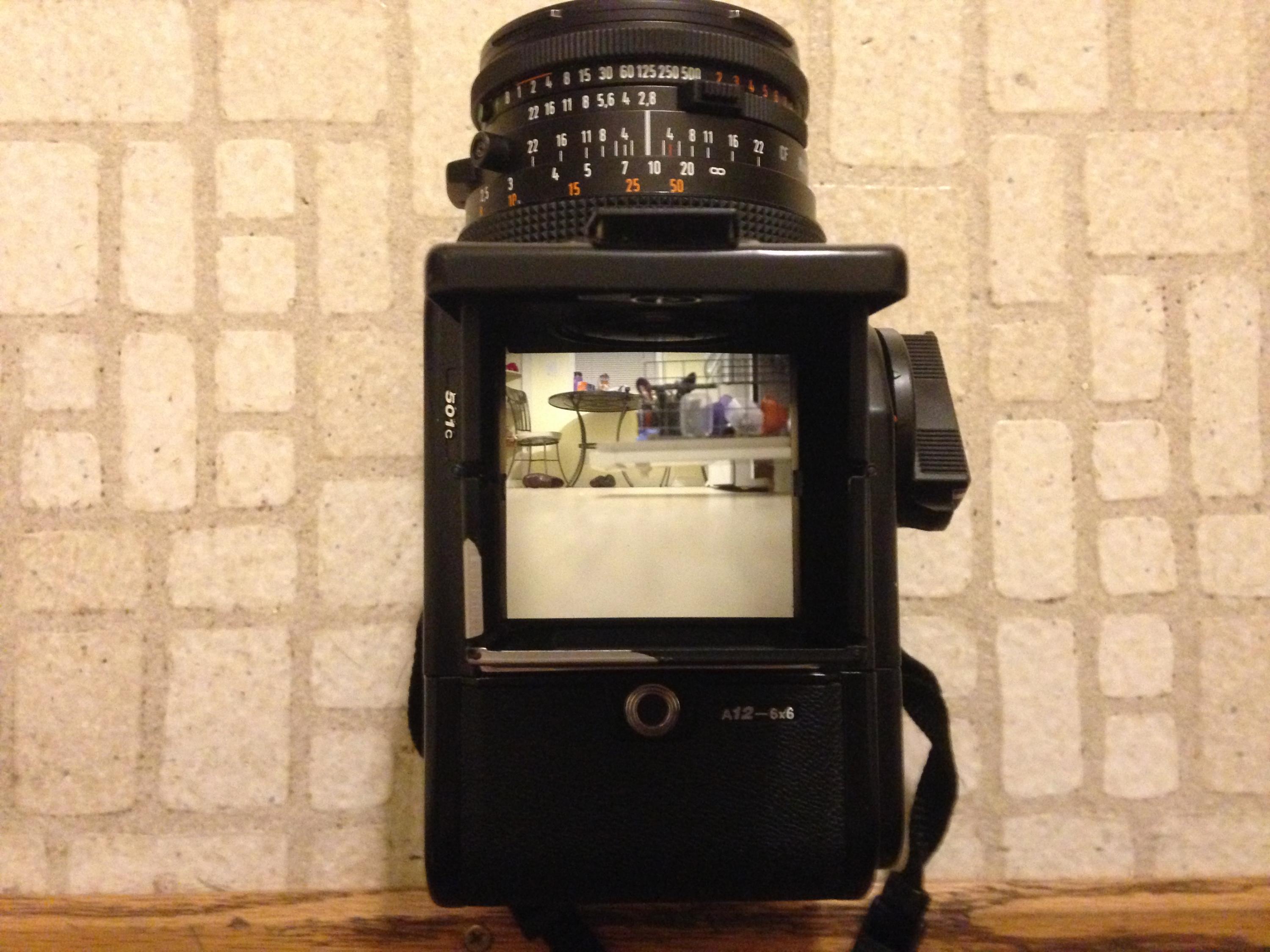

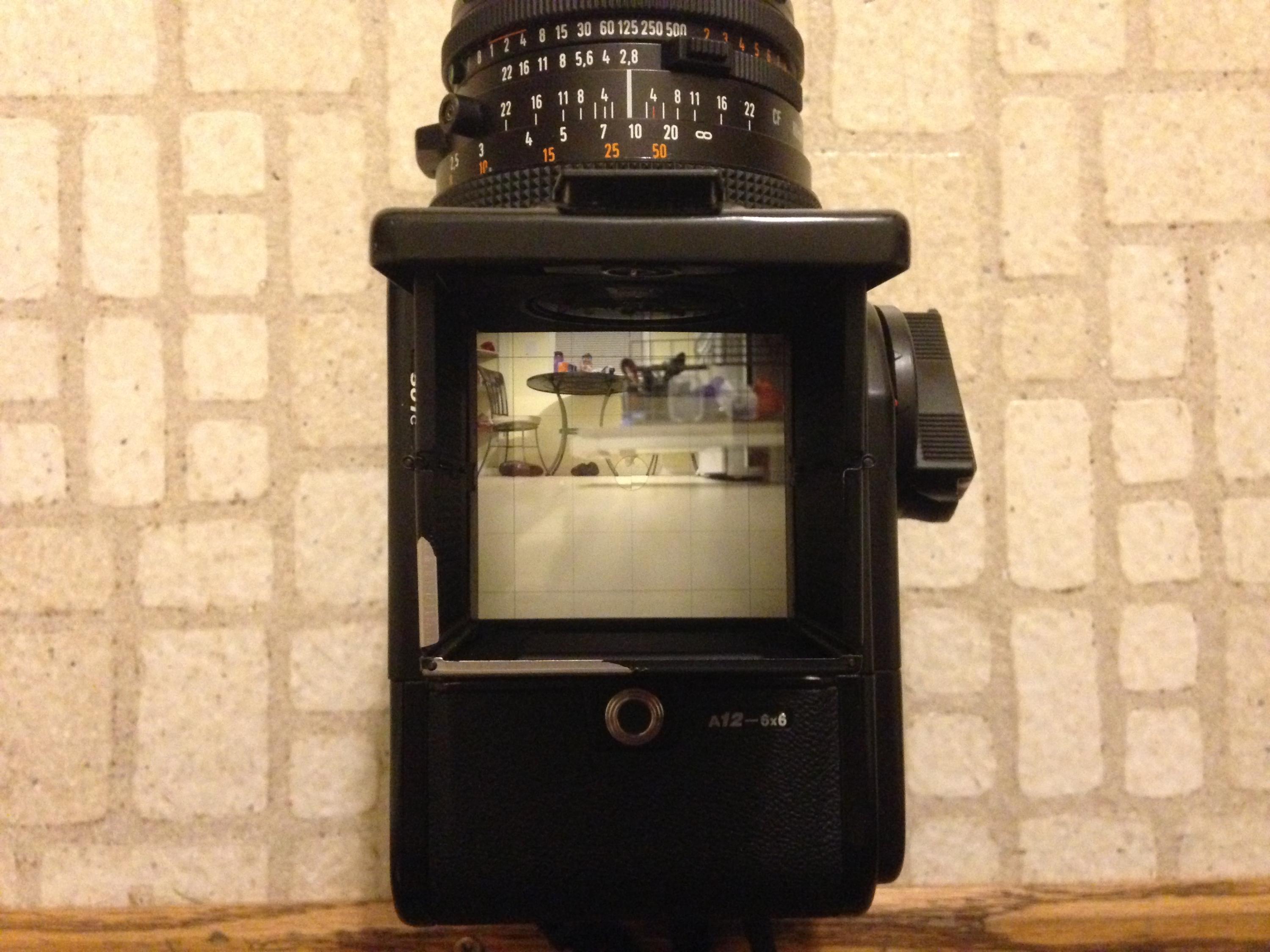

I've been using a plain Maxwell focusing screen on my 501C for the past number of years. I felt I was still having some difficulty with focusing, so I thought I'd try an Acute Matte split-prism screen. I ended up finding an Acute Matte D screen with the split prism and grid. It does have the two half circles to distinguish it from the Acute Mattes, though I really didn't care what version it was--I just wanted a split prism with a grid.
In the past I'd read that the Acute Mattes were slightly brighter than the Maxwells, but that at least with plain screens Maxwell screens "popped" more when in focus. However, to me it seems like the Acute Matte D is dimmer--I've attached photographs. Can anyone confirm if this is about the level of brightness you'd expect, or is this more consistent with the "old screens" or a counterfeit one? The grids seem slightly sloppy to me--you can't see in the photo, but one line on the right gets a little thinner and you see the fresnel lines, and I can see the top and bottom diameter portions of the split prism (ie, I see two circular lines very close to each other).
I've attached photos to show the difference. I only have an iphone so I can't really control the exposure, but I think the Acute Matte D screen (grid) is a little more exposed than the Maxwel, yet it still looks dimmer to me. It's not night and day or anything, but it still bugs me, and if anyone has any input I'd greatly appreciate it.
Yes, the camera is on my kitchen floor, looking at the dishwasher and kitchen table. It's the brightest room in the house and it's dark outside...
Certainly it's easier to focus and still plenty bright--I'm just a little anxious about a spending so much on the new Acute Matte screen and it being dimmer than my Maxwell. Thanks!

I posted in another thread that after tons of focus error, I had both bodies serviced. That laid the errors to rest, but one body had the pre 'D' acute matte & even it worked fine - but not as bright. I've seen the 'D' version, but not used it for shooting. The tech that serviced the bodies told me I'd get about 2 stops more brightness w/ the Maxwell. 'Probably not quite that much over the early acute matte, but definitely that much over the pre AM screen. 'Don't know if Sirius has experience w/ AM, Beattie, Maxwell, but I'd want to hear from him if I were you. I can't afford another Maxwell, but if I were to pony up the funds, another Maxwell would be my choice.

Hard to say from the pics, as the one on the right seems to have a little focus error or camera (phone) shake. Things are sort of blurry on that pic, especially the tiles. The image on the left is much brighter. If I had a choice, I would use the left one, even w/o the split prism.

FWIW, I think Momus is on to something. One thing I noticed before the Maxwell screen arrived was that the plain matte screen was pretty easy to focus. The 'snap' when focus came in produced as good a result as all the aids. I found focusing slow at first - slower w/ the focusing aids 'cause I was trying to get it so perfect. The matte screen was there or not - no fussing, tilt/twist to get the split clear.

Ignoring the brightness question, if both are as easy to focus for you, I would select the one on the right because the lines allow you to line up horizontals and verticals.

They are both easy to focus with--though the split prism makes focusing easier. It's been a long time since I had a split prism (my 35mm days prior to 2003), so it's a little annoying at the moment to have that large circle in the middle--I didn't anticipate that. I'll try it out for a while and see how it works. I imagine outdoors both should be plenty bright.
I have had many a picture slightly ruined by verticals/horizontals being off (I prefer to print full frame, though I make occasional exceptions), so I also thought the grid would help, which is why I went for the split prism + grid.
