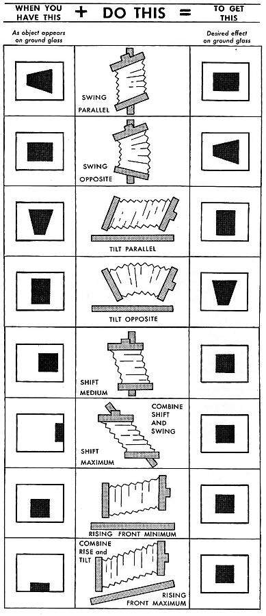

jstraw
Aug 27, 2006
2,699
Topeka, Kans
Gandolfi Variant Level III. Or buy a Linhof Technikardan: a monorail that folds down to field camera size.
Can you not obtain more lateral shift via indirect movements?
(I have both...)
Cheers,
R.
That's a good point. Yes, you can achieve lateral shift with indirect movements.
See the attachment:
See the attachment:
Good point about using swings to get more shift. What I have needed on several occaisions has been more swing. I was thinking there might be other field cameras with more. I'll look into some of the suggestions above. Thanks!
