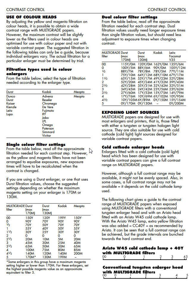

Consulting an Ilford table, with different values to be dialed into color heads from different manufacturers, based upon the max densities which can be dialed in with your color head, this gives you an idea of what Grade you should be able to choose:
