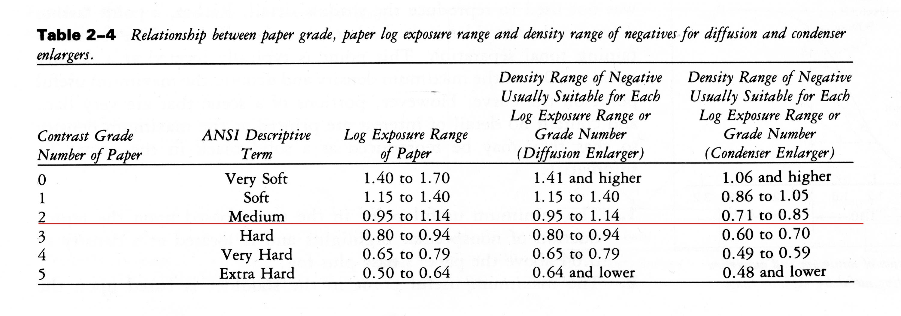

Jan 7, 2005
2,632
Los Angeles
This might help.
