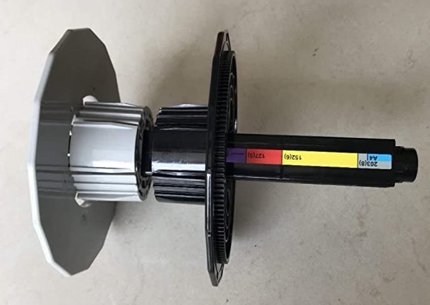

If you ever see one of these, online for sale, and the price is right, then go for it.
It is the spindle from a minilab paper cassette. Just make sure it is the correct max-width and is adjustable. If you can get the full cassette and spindle all the better. That would mean you have a light tight roll paper store and you could dispense the paper for cut sheets (in the dark of course)

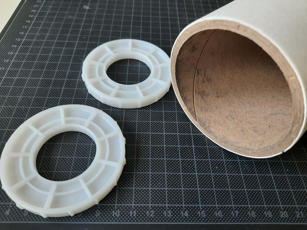

Anybody with a roll of fuji paper or with knowledge of fuji paper know the opening size in the core?
Better late than never, but having just finished a roll of Supreme, I have the core here. The inner diameter (opening) is 76mm, so 3" was right on the money.
I was also working with an older, smaller Fuji roll which had a similarly sized core, but plastic inserts with an inner diameter/aperture of 38mm (1.5"). Probably these are adapters for minilab machines, but I'm not sure about that.
Here's a quick pic of the cardboard core and the inserts. The self-healing mat has a metric grid (!)
