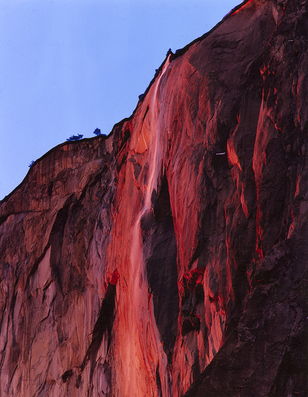

For this RA-4 print from a C-41 negative I made a normal test print which resulted in the ungainly grey sky that I wanted to change to a blue, determined the filter packsettings and exposure to produce the shade of blue that I wanted and then made a cutout to separate the sky from the waterfall. From there it was simply a mater of printing the 2 exposures.
