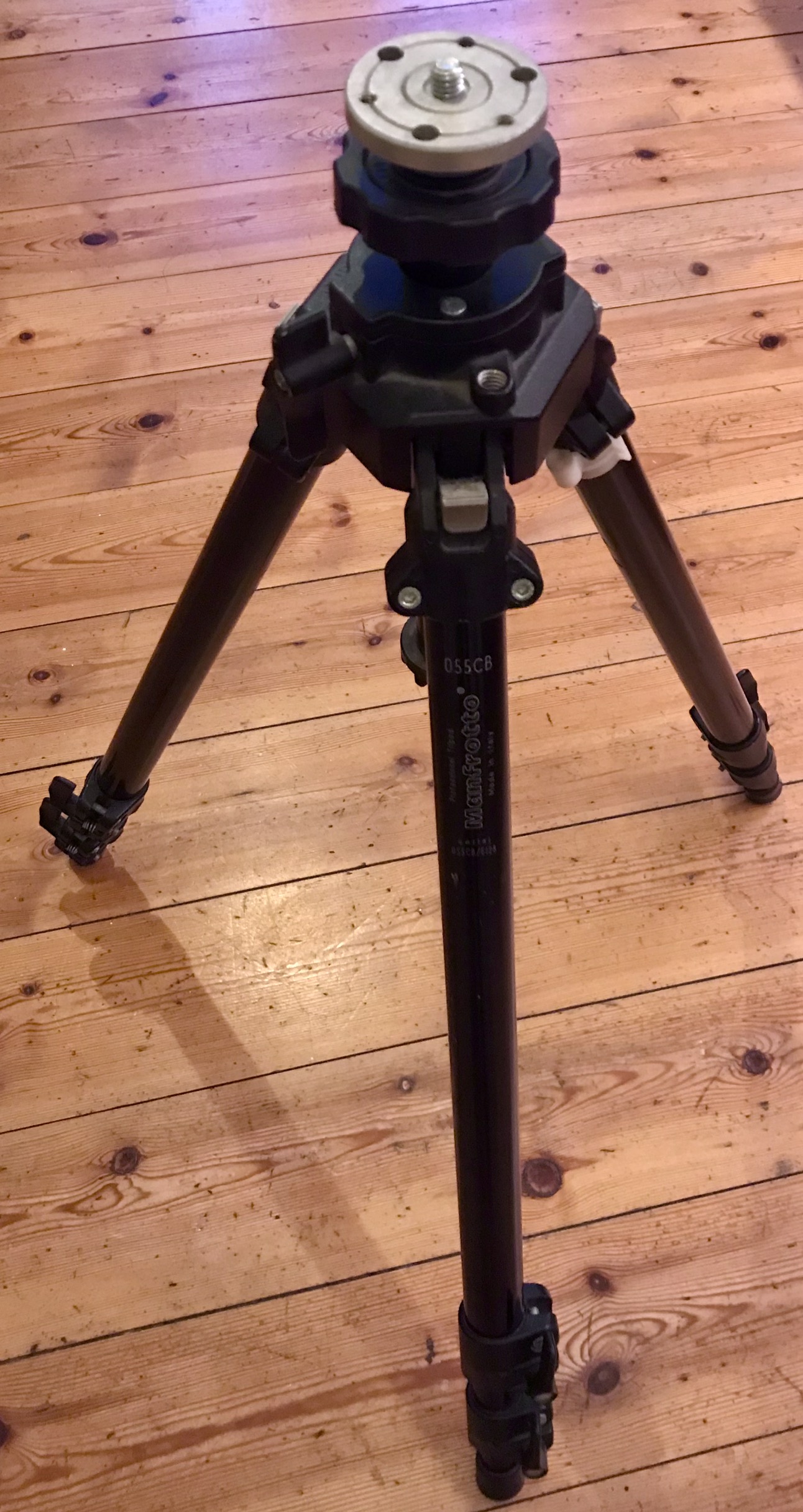

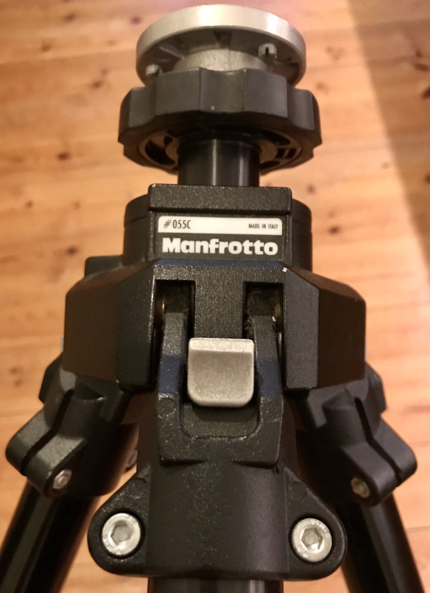

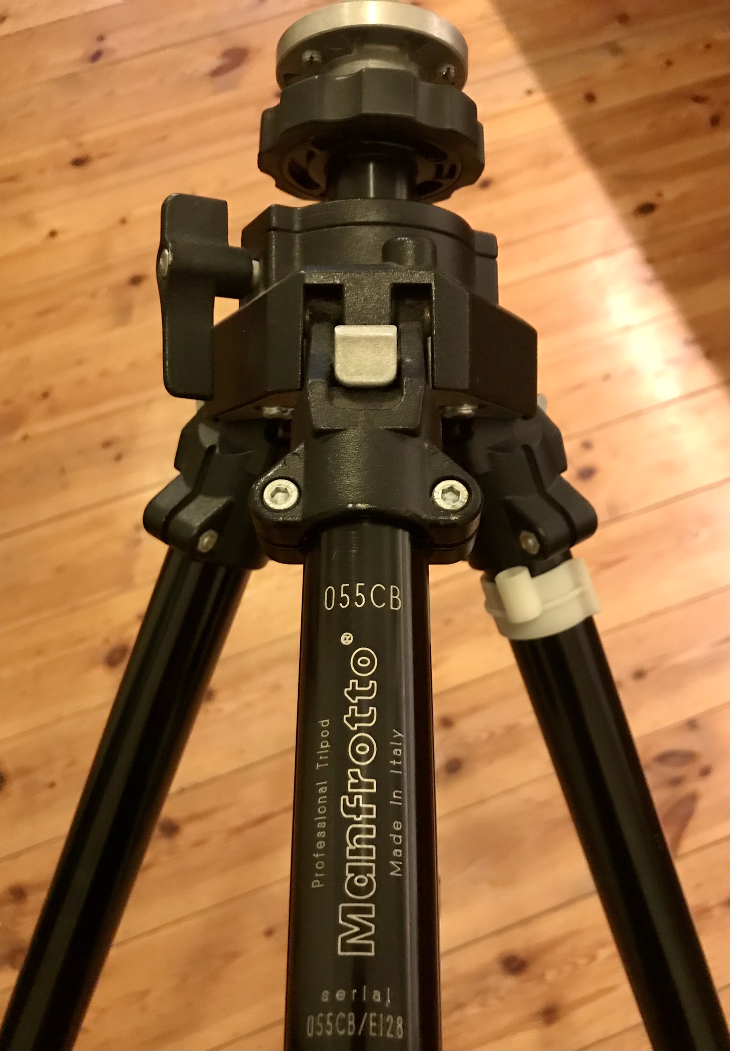

I own this (see pictures) Manfrotto 055CB tripod from the 1990ies and I am looking for a matching tripod head. Unfortunately I cannot find the specs for this „old“ tripod anywhere.
So I have two questions:

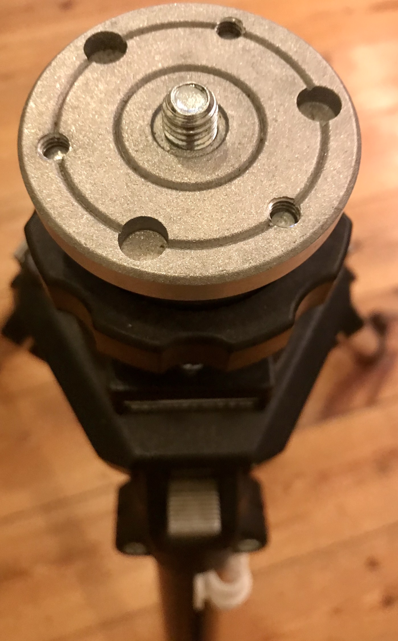

  1. When looking at the base plate with the 3/8” screw in the middle and the three somewhat smaller screws at the outside, do all current tripod heads still fit on this tripod? Which ones do fit?
  2. What was the maximum weight that this tripod could take? I would like to get a head that neither oversized nor undersized I terms of carrying weight for this tripod.
I am going to use this tripod with the Chamonix C45F-2 4x5 camera which weighs 1500g without the lens. I am thinking of getting a ball head. I welcome any suggestion of a decent tripod head for this setup.

The 3 additional screw holes are basically jam screws to keep the head from loosening.
That tripod would likely work with a wood field camera but some might consider it barely adequate.

The three set screws around the edge of the mounting platform are anti-rotation jam nuts as BrianShaw said. On some Bogen/Manfrotto heads, there is a series of scalloped indents in the base for these jam nuts to press into, but you could use them with most heads.
