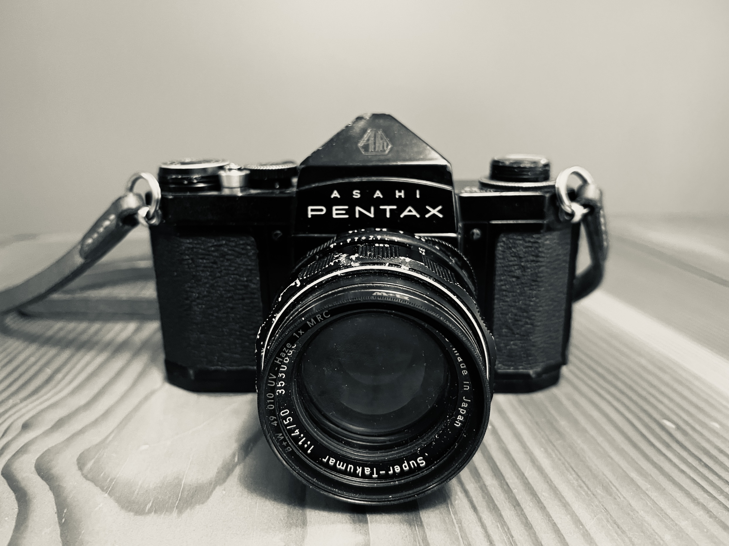

Yes, the S cameras are lovely.... I have a black S2.... every bit as nice as Spotmatic....after the obligatory service!
