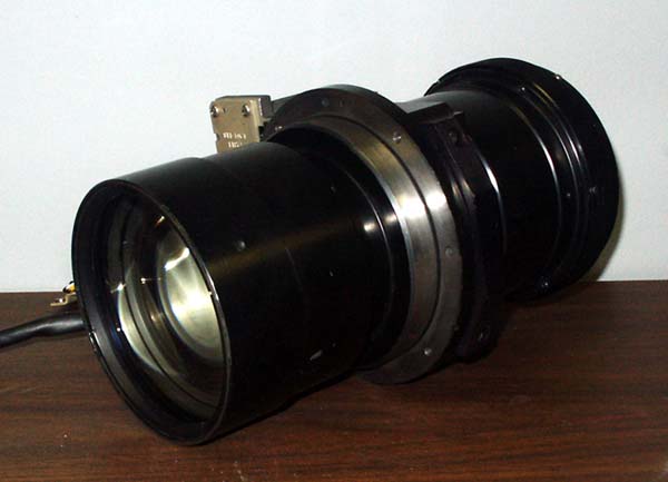

And compare that with the many thread holes on this Fairchild aerial camera lens below (at least what they appear to be, I don't know much about these aerial cameras, maybe it is something different). I already see some 4 holes(?) for bolts this side of the lens, and I guess it is bolted down with 8 or 9?
But maybe someone else knows better how these lenses were fitted in the aerial cameras... :confused:
This is a lens made by Fairchild Space & Defense Systems:

Last, according to this Camerapedia page, the K-17, K-18 and K-22 came in versions with 24 inch / F6 lens option. So your values seem anything but strange...
Here is what is apparently one of the camera systems used on the U-2 spy plane, with a rotating lens unit. The U-2 had a serious payload limit (see this Google Books link), so they had to adjust existing K38 cameras. Maybe that explains the "holes" in the lens? Simply safe weight wherever possible?
And three other images of a different camera system that was definitely on the U-2. Unfortunately, the pictures are not clear enough to fully understand the lens/shutter assembly and how it was fitted to the rest of the camera body:
From this page: http://www.nationalmuseum.af.mil/factsheets/factsheet.asp?id=9169
