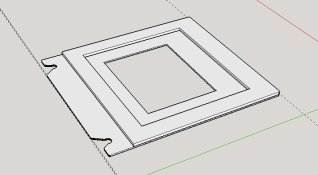

Anyway, the diffusion experiments led me to this… I learned Sketchup, got on Shapeways.com, and just got a 3D printed Beseler 67 neg holder from the mailman with a space for glass and registration pins. 3D printing… man, that's the freaking future. Imagine it and order it. Spent 30 bucks I think. Yeah, one of these days I'll get a better enlarger, but I don't wanna be that "throw piles of money at it" types...
