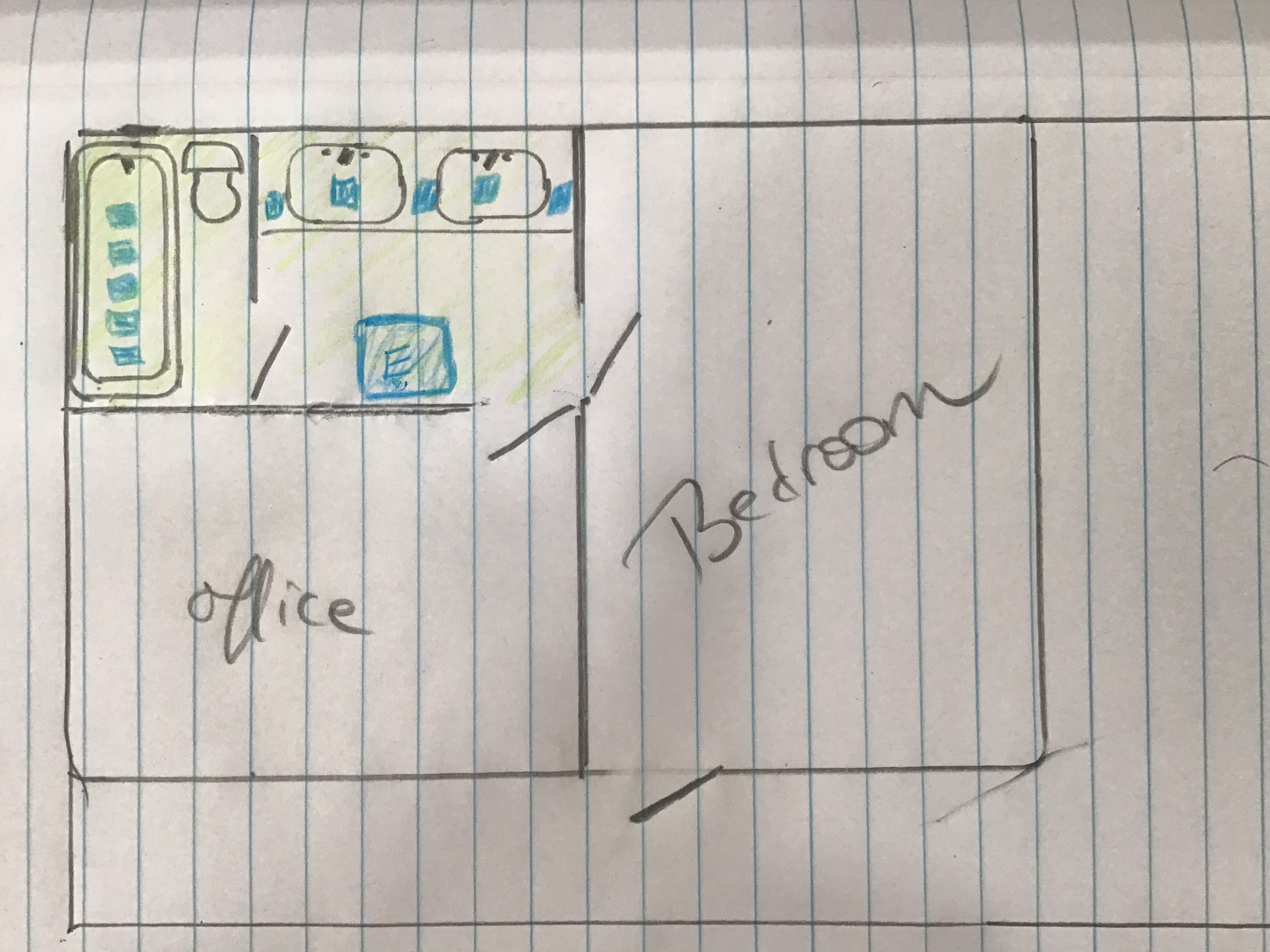

A image is added to help picture this. Thanks to all. This is about paper developing, 21st century problems. I‘m a whiner.
I’m doing the daylight nikkor film development in the garage with the garage door open in the heat, and it’s working out fine. That I can do during daylight hours like lunchtime. Seems like all my neighbors don’t work, must be nice, but it’s tiring watching them peer at me wondering what BombMixing I must be doing. Colored liquids in plastic and amber colored bottles, stainless steel large and small containers, shaking, checking my watch, an alarm timer going off, pouring out stuff here and there, I’m wearing Nitrile gloves, then using a funnel to save liquids. Across the street neighbor put in hurricane windows super clear glass and he kept having bird kills, they fly right into them. One dove struck and somehow flew back crashed in front of my house on the sidewalk. I saw it, he walks over and he explained why it’s happening, it’s alive I pick it up, neck is part broken, can’t move it’s wings it’s partially paralyzed. I wring its neck and throw it in the garbage, the neighbor throws his hands up in the air exasperated and yells, “AYYYY!” and storms off into his house. I’m not sure film development helps to endear me to neighbors on my street.
The rest of the process has to happen at night. And when I say night I mean 9pm-1am.
I see folk recommend charcoal air filtration etc. I just don’t see me using anything w a fan w family trying to sleep And I do enough fabricating I don’t want to make hanging boxes filled w charcoal and rinkydinking a setup to make it work. I’m really need feng shui this whole affair.
My sense is no matter where inside I enlarge and develop it’ll cause some remnant smell because of the enclosed space, non circulating A/C, reliance on water sinks etc. I really can’t run fans outside even in an enclosed bathroom while family sleeps. There‘s one very small outside window in the bathtub room. I’m using 4x5 trays nearly filled to the brim for paper develop-stop-fix in the bathroom double-sink area then the larger 8x10” trays in the bathtub small room each tray half filled for the hypo toner and photoFlo w additional trays plain water to wet rinse and run water in. I may have too much liquids - the fixer when fixing does sometimes smell w a burn and I open the doors to air that out a bit. Concentrations are correct.
A. I know everyone has their issues. I’ll buy different chemicals come next needed order. I’ll likely try to move the entire bathtub system washing regimen and toning outside in the grass (either at side of the house‘s zero lot line w the outdoor faucet head, neighbors likely not going to like that, lest I do it w a hose and run it to the rear. This will be tricky in the dark, and not stirring neighbors with running water. And transporting wet paper in-out is not ideal at all. Again this is at night). And wash surfaces better w Mistolene added.
B. If I decide to scrap the whole interior dance, I’ll need to see what I can do for enlarge and develop, all of it, in the garage at night. I’d have a lot of seams and window to block, it’s quite warm even at night, will need to constantly alternate opening the big full garage door and all that noise every time, and when lights are turned on bugs and insects come in heavily. I can only store my enlarger and chems upstairs inside so that’s no fun back and forth transport w stairs. A garage solution is comical and I’ll frighteningly become a nut case.
Attached find image of layout. Blue are trays (trays in sinks are water and for running water) enlarger on floor. It’s very tight as you could imagine. I have to close all three bathroom doors when working to limit the noises I make, to keep any interior lights shut out, and to prevent the outdoor neighbor lamp light coming in through the small bathtub area window. A BB gun isn’t an option despite It being Florida. That’s tongue in cheek; my brother is hassling me a lot now for living in this state. He’s from Wash DC, no surprise. I send him postcard prints now and then and he never even recognizes their receipt nor thanks me for sending them…
I’ll first get some Mistolene and douse the sinks and tub plumbing and scrub the tub w a wash down etc. Maybe I’ll sponge the satin paint walls.Thats what that paint was for. Doesn’t make sense, the scent can’t just linger in the AIR week after week - the chems went down the tubes. So the odor HAS to lay remnant somewhere. I must be neglecting a full clean. I’ll report on results.. thanks for your well thought reasoned suggestions! MattKing/GrainElevator’s recommend is now plan B.

I really think the only logical solution is some kind of fan to exhaust fumes from the room while you are working.
To be clear, your bathroom does not already have an exhaust vent fan?
If not, is installing a bathroom vent a possibility? That may require making an opening in an exterior wall - not terribly complicated if you own the building, but if renting, may require permission from the landlord.
You could install an exhaust vent <like this> in your window. Would require making some kind of plywood insert to fit your open window, but no permanent modifications to the building would be needed.
For an exhaust fan to work, there needs to be some way for air to get into the room to replace the air the fan is pumping out. There is usually enough of a gap under doors to let in air from adjacent rooms - unless you have those blocked off to keep it dark. You can get light-tight louvers that let in air but not light. If you put the vent in an exterior window, that would be drawing in un-conditioned air - probably too hot and humid in Florida during much of the year. If you put the light-tight louvered vent in an interior door as opposed to a window, it would be easier to controll the temp and humidity in the bathroom.

I'm not sure how building codes in Florida are, but a bathroom should already have a ventilation fan that exits to the exterior. This should be accomplished via a sealed run of duct. Out here, it's insulated flex-duct that we use.
For clients out here I always try and exit fans through the roof. Some balk at the extra expense of making sure that step is done right, but it results in a shorter run of ducting 90% of the time. Otherwise, I try and find an out of the way gable or section of wall. If you have finished space above, the operation can be accomplished with only 2 holes in the ceiling; the hole for the fan, and a 16" x 16" over near the exit wall. (big enough to get hands and drill in)

My house built 2004 has a bathroom without a ventilation fan. But does have windows luckily. But I agree, a bathroom with no windows or vent fan does sound like it'd violate some sort of building code. Could check if it's in violation and if you're renting, you can demand to have one installed
