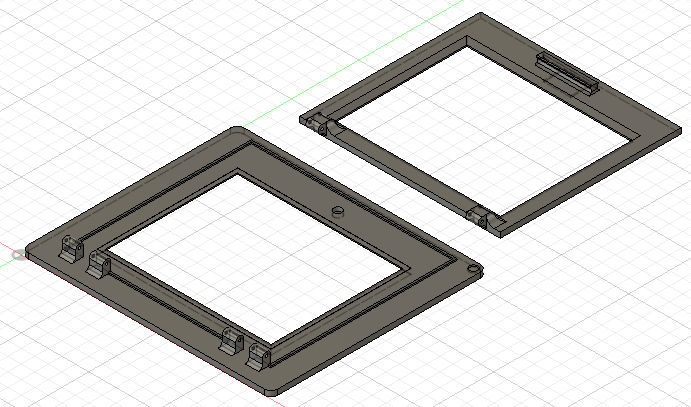

Nice. I made something similar recently:
It's a 2-piece design like yours, but with a hinged lid. I included a recess for a little cylindrical magnet in the baseplate and a metal plate in the lid so that it snaps shut. For the hinges I generally melt plain iron nails (1.8mm diameter) through the hinge holes.
Since sheet film is quite stiff, it sort of works OK but for critical sharpness and big enlargements the sag can be a problem. A tensioning system or a glass carrier is preferable for those. These 3D printing thingies work in a pinch and for non-critical stuff.

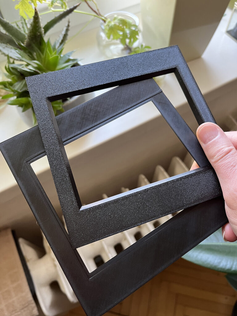

Thanks a lot! Will test it soon! any tips? how ave you been finding it in use?
I used it for a year or two; it worked OK but wasn't as solid as a factory made film holder. It did the job, though. Note that it's glassless, so your negatives may sag, depending on what film you use.
