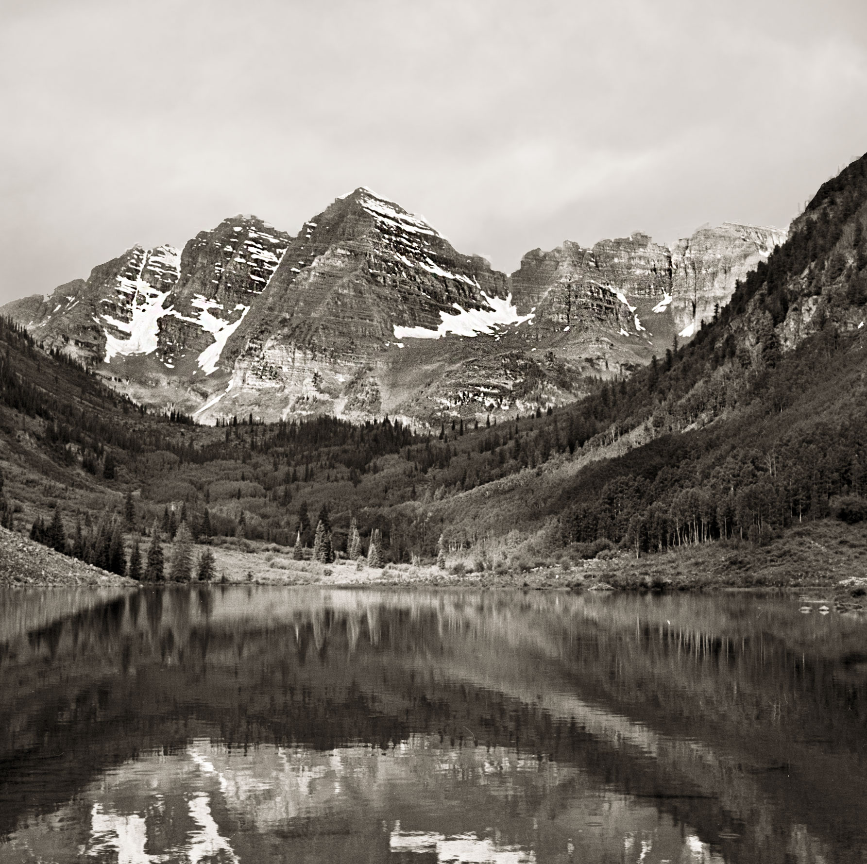

Maybe twenty years ago when in Aspen never having seen A A's photograph I was at Maroon Bells and hiking up the trail carrying my camera and an aluminum tripod when a lightning storm started up. I stashed my tripod in the bushes thinking I could be holding a lightning rod. I dashed back to the car waiting for it to clear. After the weather cleared I went searching for my tripod and fortunately I found it. On my way back to the car I took this image. I'm sure there are thousands of similar ones of the same view out there.
Very nice and worthy of a large print on your walls.

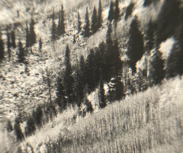

I don't know about the actual print, but the shot on the web shows trees completely black. So who needs shadow details? How does the zone system fit into his aesthetic look which frankly I like the way it is.
Those trees are not black. The details are there. This is from a calendar.
