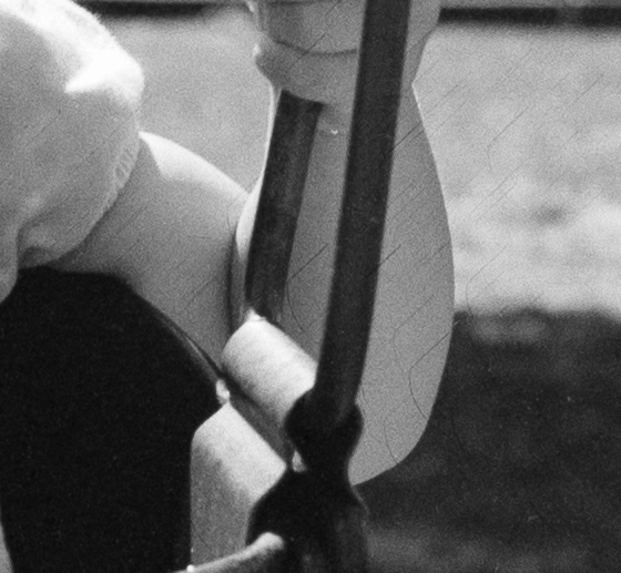

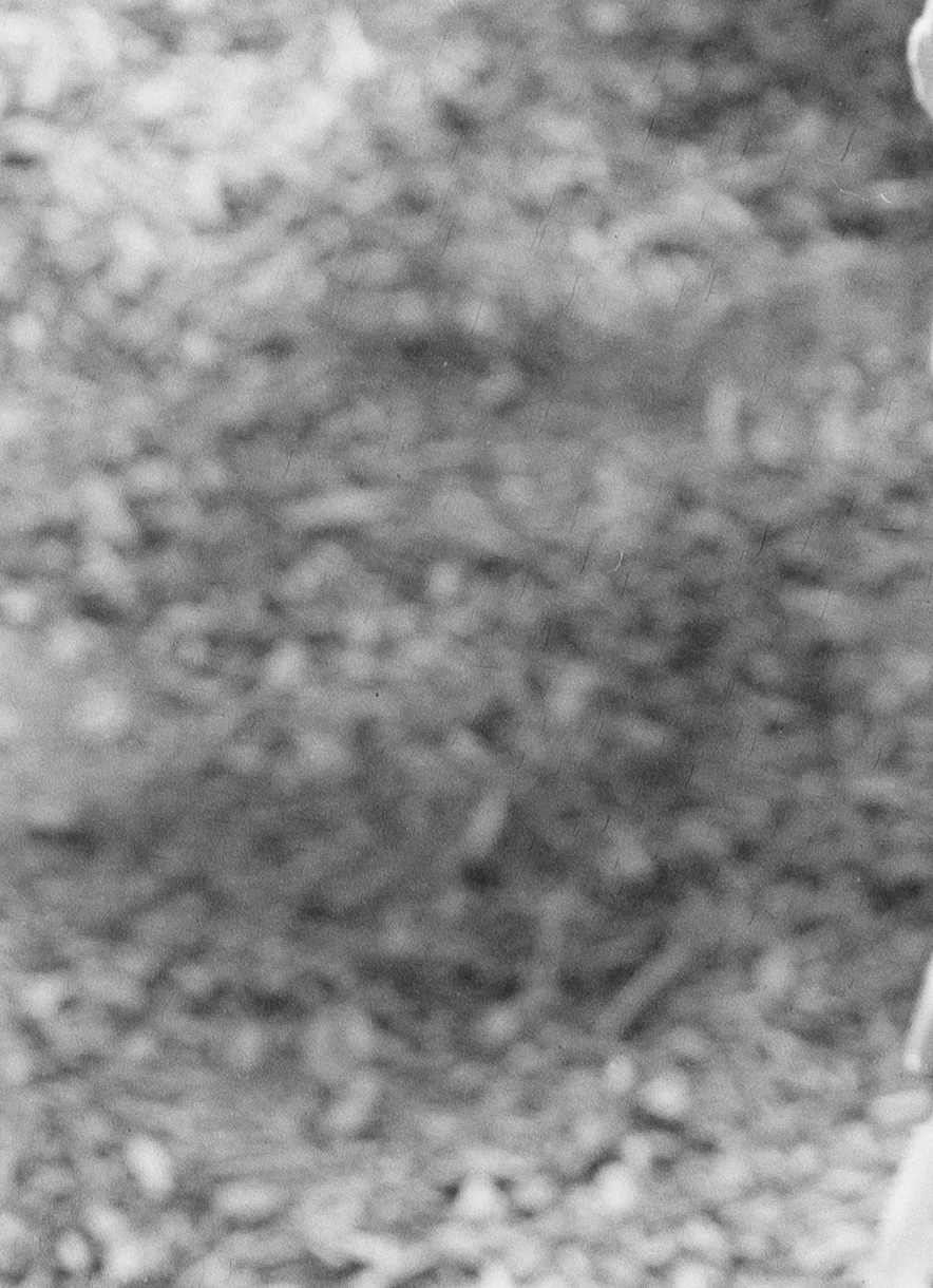

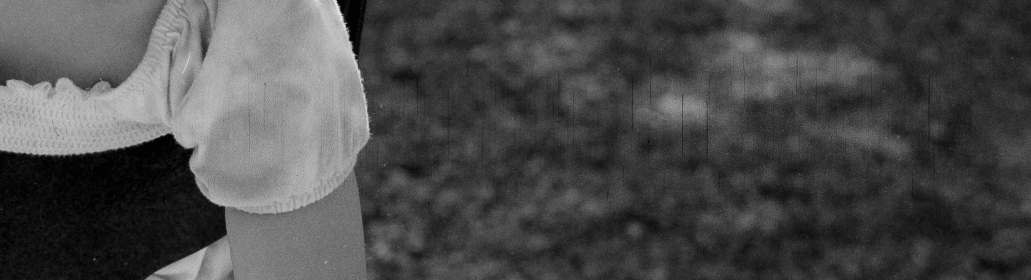

Yes it's cheap film, no i wasn't expecting much, just wondering if this is something I caused or the folks over at shanghai are known for? debris in my developer? other user error? it's not on every frame so i don't believe it's the camera. at least it was a test roll

is it 35mm? and are all the shots normal orientation? I ask because shot 1 the scratches are all about 45º clockwise, shot 2 are straight up, and shot 3 are maybe 15-20º clockwise. That makes it unlikely to be camera scratches--those woud all tend to be at the same orientation. I'd guess manufacturing defect, but there could be other causes.

Yes all correct orientation. As long as it doesnt look like a developing issue i am not worried, i think it should be attributed to poor handing when i was loading (i did have to restart loading this reel in the bag 😅) or cheap shanghai film manufacturing, it was only 3-4$ a roll on ebay!
