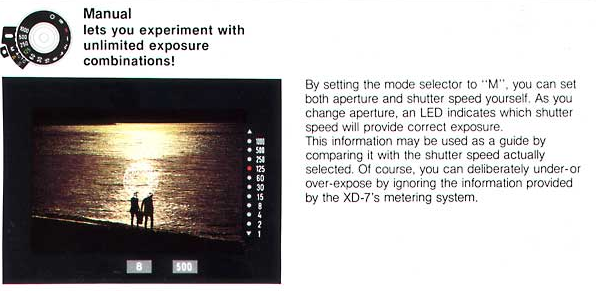

The Minolta XD/XD-7/XD-11 would qualify as its manual shows all 3 bits of data

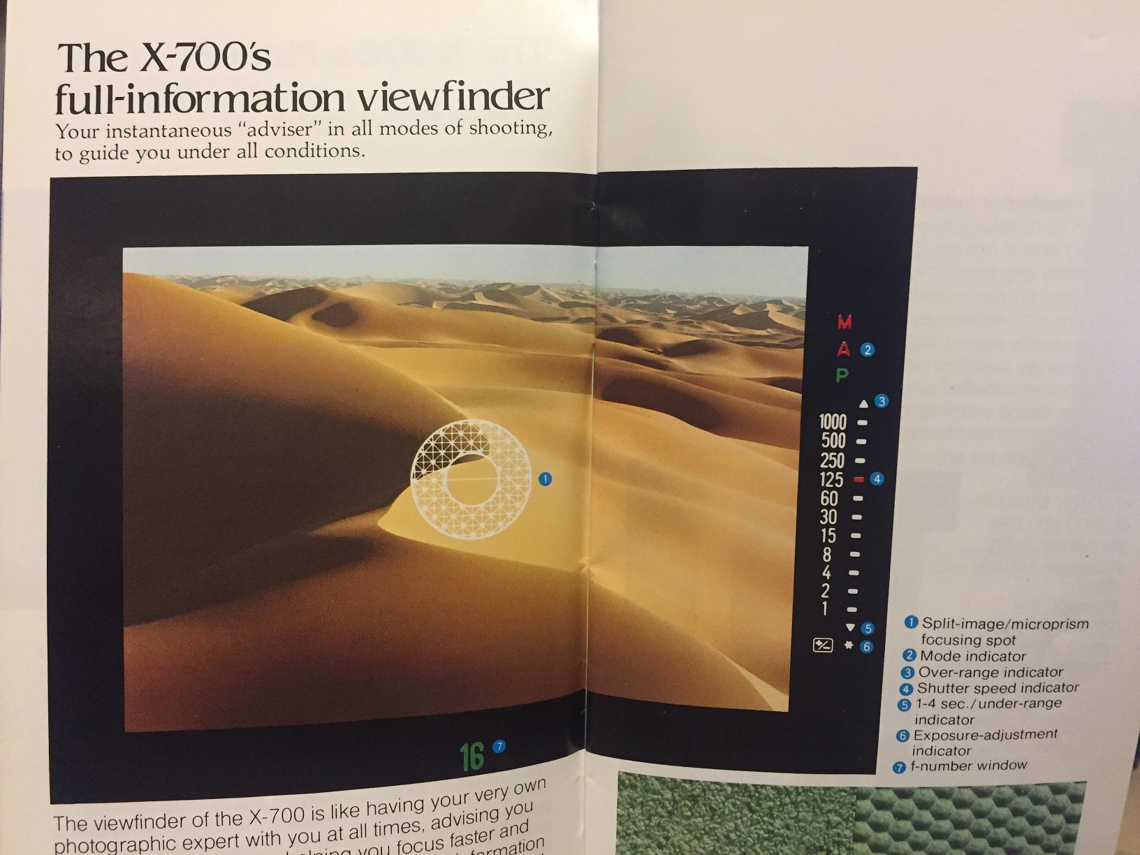

Minolta X-700.
Program Mode
Aperture Priority
Full Manual Mode
Shutter speeds, aperture window, LED Readout that shows suggested and actual shutter speed LEDs in manual mode
Exposure adjustment +/- indicator flashes in viewfinder when you have that activated. (Doesn't tell you if it's over or under, just that it is engaged.)
Minolta MD lenses are great and relatively cheap
(Sorry for the crappy snap shot)
