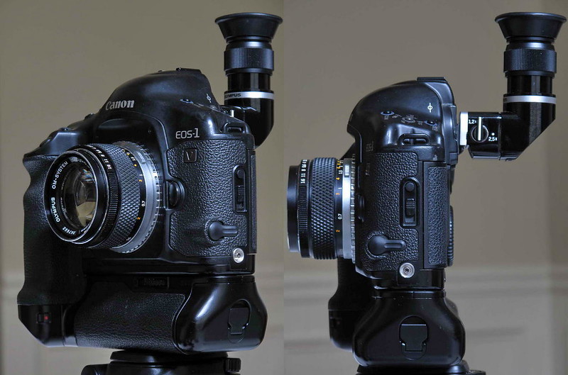

I used an Olympus OM to Canon EOS adapter and can use OM lenses on my EOS1. THE OM Varimagnifier also mounts and works great too . . .
EOS1 OM by Les DMess, on Flickr
The same applies to my four Rebel 2000, 7N, 7E, and IIe.
