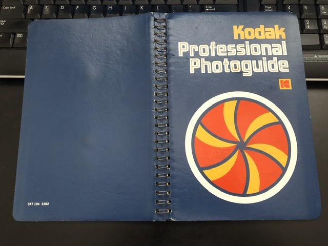

I also think that the old Kodak Professional Photoguide have a calculator for that but would have to verify.
This should be easy to find at cheap price. Four pages of how-to plus a calculator to help.
