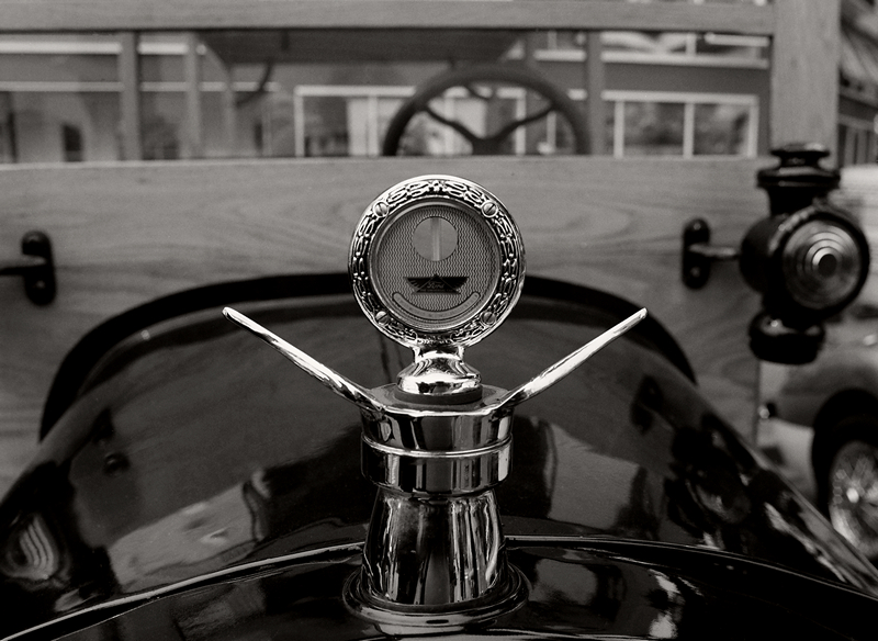

The 55mm lens is relatively tiny. I have the relatively rare waist level finder for my camera, so as long as I'm comfortable with landscape orientation only, I can go out with the 55mm lens and WLF on and the combination is wonderfully light and compact - great for something like the local on the street annual classic car show. The 80mm standard lens isn't a lot bigger than the 55mm lens.
This example is one of the 55mm at the car show examples, resized down for the old Photrio requirements:
