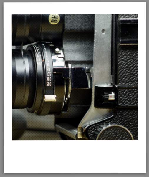

The 180 SUPER I have cocks automatically on my C330.
I have just tried mine. Not only is the cocking lever too short, it also jams against the side of the shutter.
Looks like my 180 is reserved for use on the C3.
Mine is the chrome version, not the super.
As is mine.

Some chrome 180mm lenses will not work on the C33/C330. It is to do with the location and arc of motion of the cocking arm. Later Seikosha-S shutter 180s and the black Seiko shutter lenses should be fine.

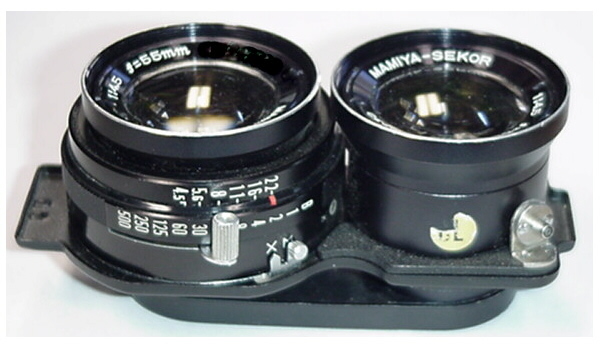

Here is why I replaced my 65mm f/3.5 Mamiya lens with a 55mm f/4.5.
When I used the 65mm f/3.5 Mamiya lens on my 6x6cm TLR to photograph groups of people, I was not getting the coverage that I needed. Based on my shots with a 35mm SLR camera, I knew that my Mamiya needed a wide-angle lens that gave me a horizontal angle-of-view similar to a 35mm focal length lens on my 35mm SLR.
The 65mm Mamiya lens I had been using had a 46.61° horizontal angle-of-view. This horizontal angle-of-view is between the 48.56° horizontal angle-of-view of a 40mm lens and the 43.60° horizontal angle-of-view of a 45mm lens on my 35mm SLR.
The 55mm Mamiya lens has a 53.96° horizontal angle-of-view. This angle-of-view is closer to the 54.43° horizontal angle-of-view of a 35mm lens on my 35mm SLR.
