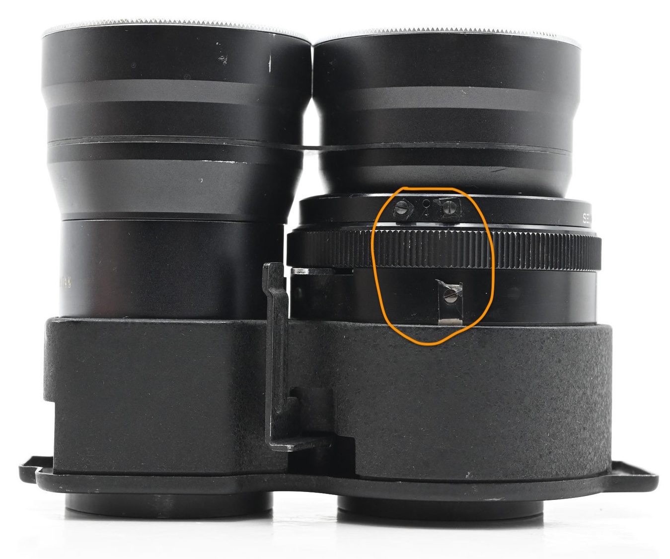

I got my 180mm Mamiya TLR lens out today, and while mounting it, the plastic piece that links the aperture ring to the actual aperture mechanism basically crumbled off. It looks exactly like this (not my photo):

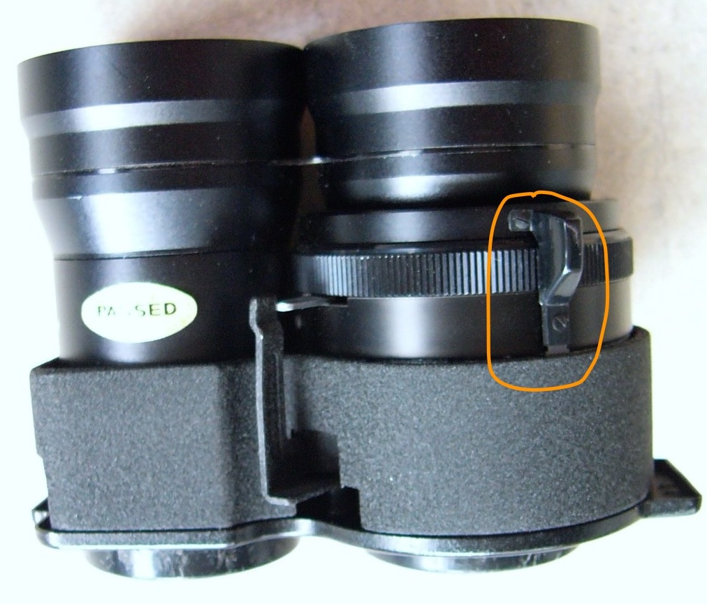

Here's what it's supposed to look like:
Anyone have a lead on a replacement for that? If I can't find one, I'll try to either fashion one out of metal, or else model and 3D print a replacement, but I figured I'd ask here first.
I’ve had this lens for years, it’s not new to me. Can’t even honestly remember where I got it.
Sometimes this is a case of needing to buy a damaged lens for parts.
Thanks everyone. Bill Rogers has the replacement part in stock, and I've ordered one from him.
