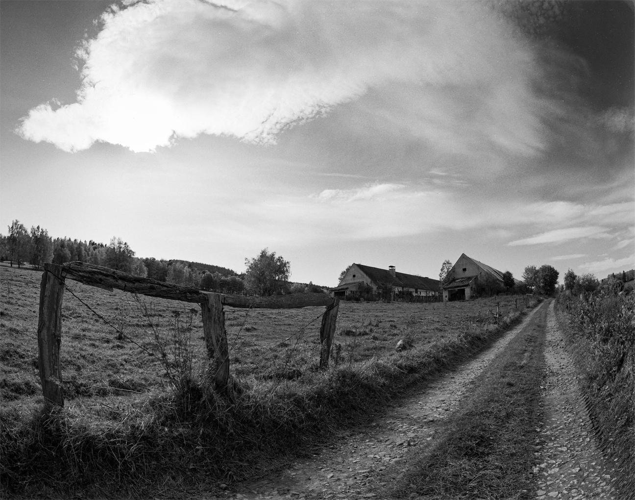

The Sekor C 37mm f4.5 has arrived before a while (bought for 580 EUR). I was wondering what is the horizontal angle of view if diagonal is 180°. So I did some rough measurement and it results to about 107° for horizontal angle of view.
I did it also for Sekor C 50mm f4.5 and it is about 69° for horizontal angle of view (Mamiya official value for Sekor 50mm is 81° - it is most probably for diagonal angle of view.)

Trip to the End of the World
Mamiya RB67 Pro SD + Sekor C 37mm f4.5
Fomapan 200 dev. Fomadon Excel at 20°C for 6,5min

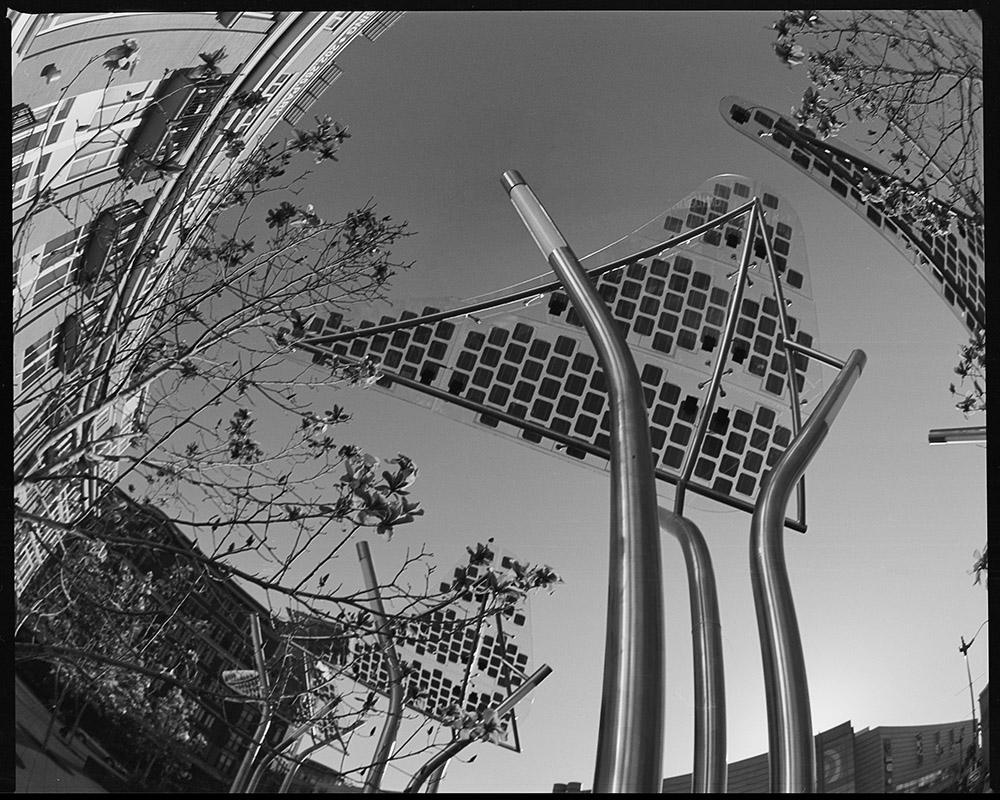

Noosa River, 37mm Fisheye, #006
Gelatin-silver photograph on Ilford Classic VC FB photographic paper, image size about 16cm diameter, from a 4x5 Fomapan 100 negative
exposed in a tachihara 45GF field view camera fitted with a Mamiya 37mm f4.5 fisheye lens and red filter.
