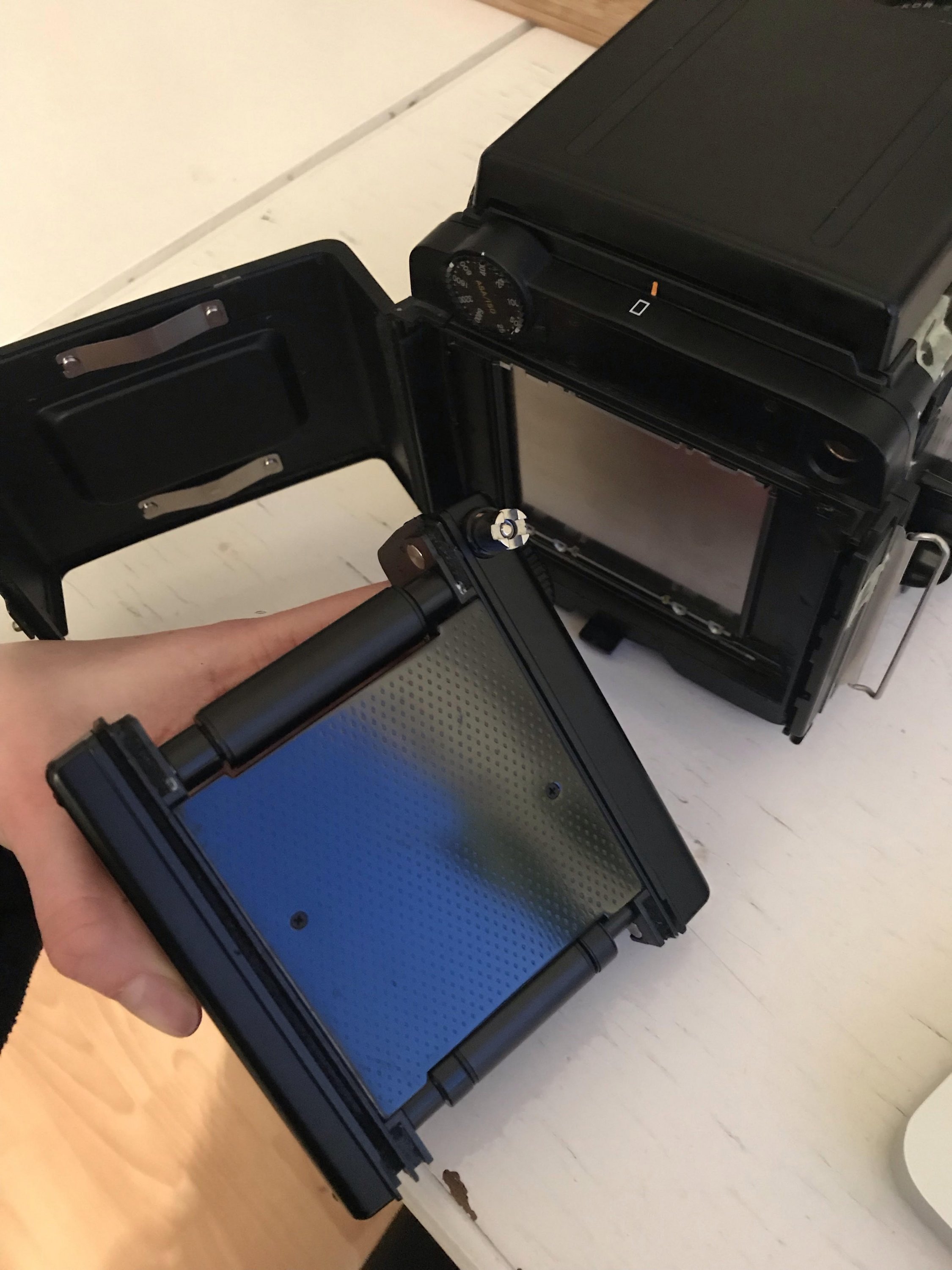

The pressure plate, looks large/normal sized to me (aren't the pressure plates identical for all formats?):
I noticed that there are empty holes for screws, 2 on each side. Maybe this is where the correct (or any other) mask would be / had been attached. My regular 120 back is loaded, so I can't check it on there atm.

Thanks for posting the image. No, the pressure plate is the size of the exposure. I have a 6x6 and a 645 back for my RZ (in addition to the 6x7) and the pressure plate is different for each. The aperture of the main housing is also different, serving as the "mask" correlating to the format (6x6, 645, 6x7) being used. Hope this helps!

The Mamiya RB-67 had a 6×3 back. This may be that and put on the wrong camera. Of course, telling you this 4 years later may not be so helpful. …And yes, there is missing mask. Perhaps someone tried to alter the RB-67 back to work with the RZ67 and messed up big time?

Is the 'RG-67' a typo? I can't find any info on such a model number. The back is definitely not a RB-67 back, as it has the more square corners, RB's are rounded. In either case, I can't find any info on a 6x3 back anywhere. If there is such a beast, I'd love to get one! :smile:

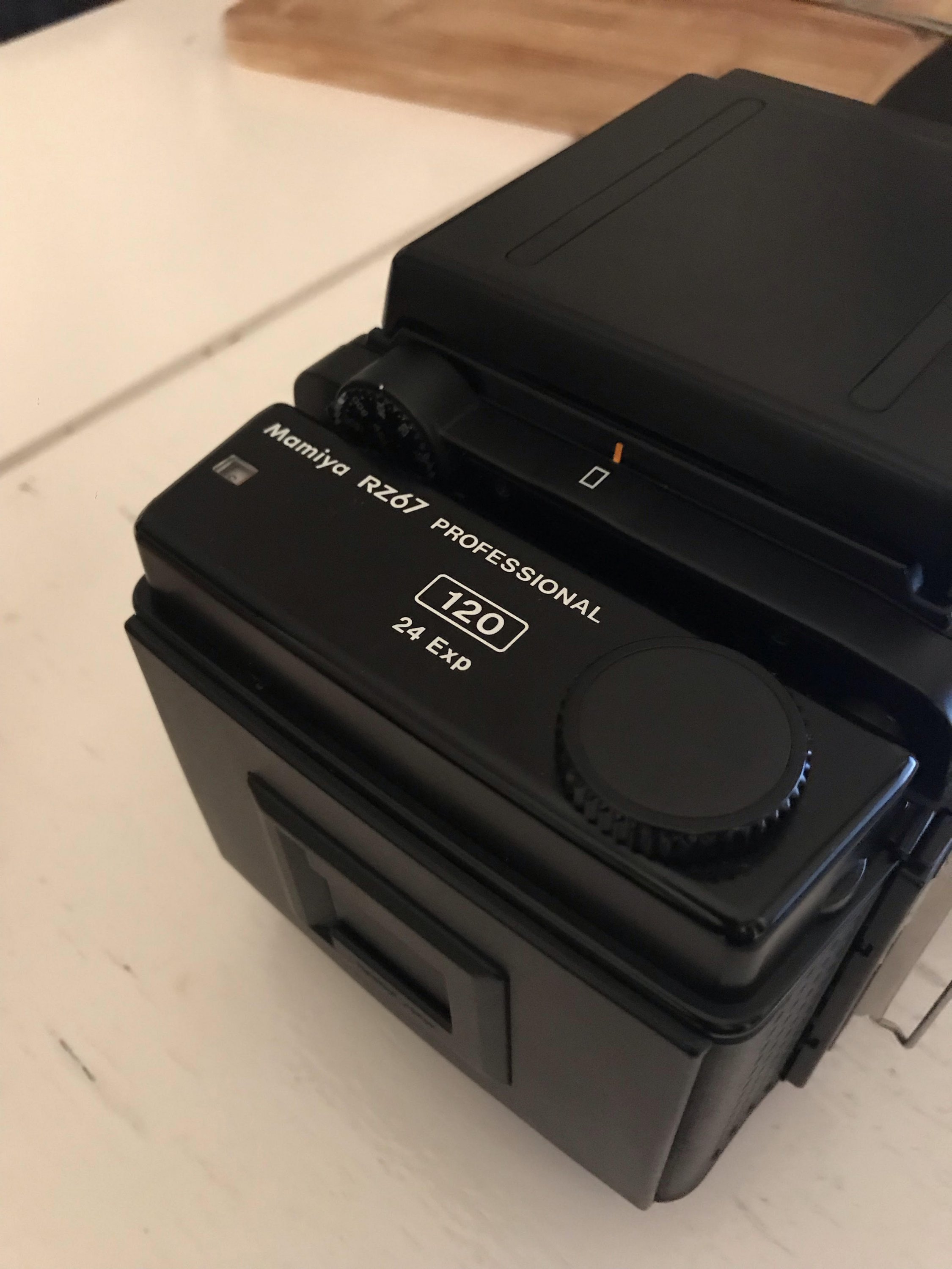

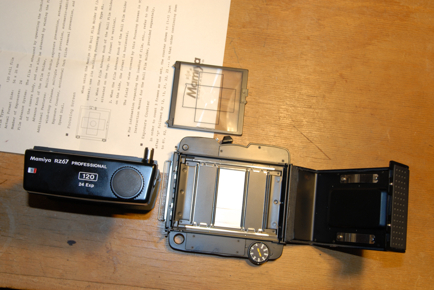

You are(maybe) in the possession of the rarest of the rare back for Mamiya RZ67 (or maybe half)!? This is a 56x26mm back specially made for Dutch law enforcement. I have one too :smile: I start looking for pictures; but I think yours missing a 'right' mask?

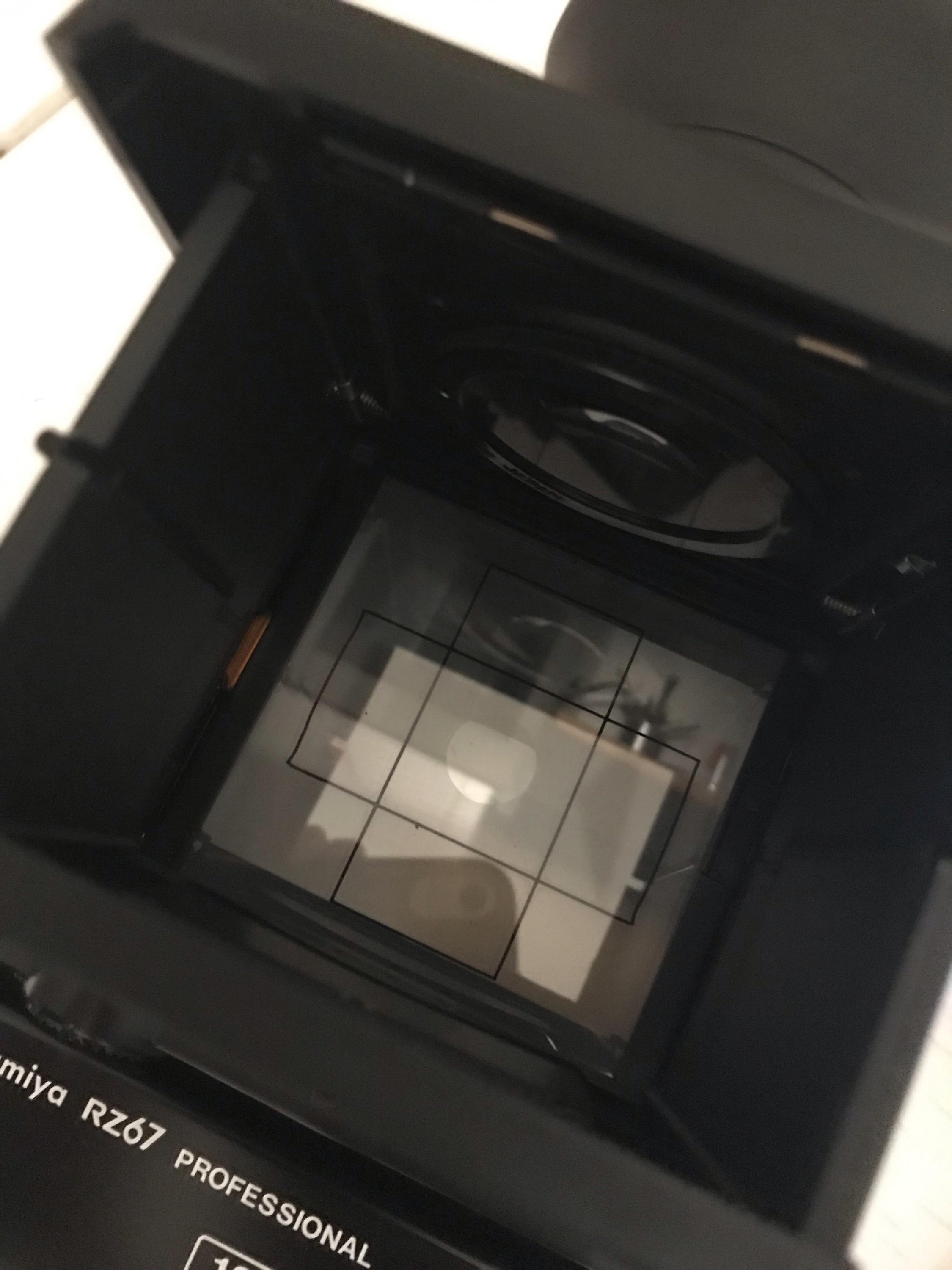

as you can see you need a special focusing screen too.
Apparantly, I'm also in the possession of such a back. I have the same problem as Sewarion with the counter exposure and overlapping images!
What is the name of this back? and is it not possible to change this back to a 6x7 format?

View attachment 152438 you don't have the 'right' mask; look at my picture. You have two systems mixed up, but you do have the right groundglass so you're halfway there :smile:
