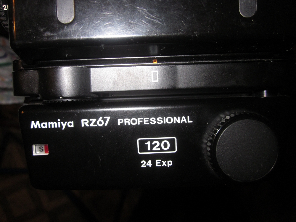

hi there,
I recently acquired a Mamiya RZ67 with two lenses and a 120 back. I'm having some strange problems concerning the back:
- the back says 120 (the number is 'framed', and looking at some backs in real and on the web, this is pretty normal)
- below this 120, it says '24 Exp'
- the back is definitely 6x7, it can also revolve, so far so good, but..
- it does not produce 10 single frames on a 120 film. it produces a seemingly endless succession of - here comes the funny part - about 24 exposures which are overlapping.. I will try to scan it somehow as it is difficult to describe, but it's just like after one third of an image, the next image 'begins', and it's just one big mess
- accordingly (?!) to this one-third-image thing, the counter in the back does not start with 1, but with 11. It then goes on with 11, 12, 13, 21, 22, 23, 31, 32, etc.
- When advancing the film by cocking the shutter, it feels very much like the film wouldn't be transported far enough. Before the halfway point, the wheel on the film back stops turning, when I push down the cocking lever further it makes a strange sound and finally cocks the shutter and releases the mirror. Like it would turn operate in idle, which it seemingly does, as the film is not transported further.
- So I don't really think it's a malfunction of the back, as the weird numbers in the frame counter indicate it is seemingly supposed to do 8x3 exposures.
- But why on earth are they overlapping? And what's the point behind all this in the first place?
- The camera is completely useless to me in this condition.
Basically I am left disappointed, and puzzled. I have two main questions:
- What weird kind of a freak back do I have? I really tried my best to look it up on the web, but just couldn't find anything on the back.
- Is there any chance to make it operate as a normal, 10-6x7-exposures-with-frame-borders, back?

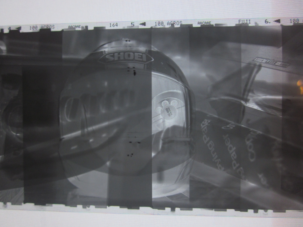

Well, here is the promised 'scan' - as I do wet printing only, I had to photograph it with a small digicam, but it becomes clear what I am talking about anyway:
What makes me think of malfuction is, well, the result in the first place, as I can't think of a way of intending this mess. There is also the strange/incomplete cocking action by using the lever.
But then I get puzzled again by 11-12-13-21-22-... and the '24 Exp' designation.

Does the "24" look like an after-market add-on?
I wonder if someone has modified the back, with the intention of inserting some sort of mask, all to permit 24 pictures on a roll.
Something for stereo photography?

It's not intended to be used with a 35mm adaptor, is it? That gives you 24 mm by 65 mm panoramic exposures. If it is, you need to rotate the film pressure plate to set it back to 120 format. Easy to find out - if the pressure plate will rotate, rotate it and see the difference.

Looks like a 6x3cm back. I believe the little white rectangle indicates the orientation of the frame.

Wow. And why then the overlapping images? Because the 'hole' (film area to be exposed) is clearly 6x7, not 6x3.. can this be some mask missing or so?

I've never seen such a thing either, but I think ic-racer is right about "6x3 back missing its mask". 24 exposures would be right for the 6x6 220 back (which exists) but it clearly says 120 on there. Your recourse to the seller is to ask to get the proper mask for it. I don't have my RZ here but I suspect the mask is part of the outer part of the back while the advance mechanism is definitely in the insert; it's possible the seller has inadvertently swapped things up and there's some poor bastard out there with a 10-frame back that shoots 6x3cm with massive gaps...

MattKing, I just measured the width of the first image before it becomes overlapped by the second: 24mm. This would make the ratio 1:3, which I find pretty cool. It takes only roll film, though.

The very earliest of RZ film backs did not have a directional arrow printed on the advance knob.
From your image of the back...this would appear to be a back from the early days.
Also, a normal 6 X 7 back will show the 'landscape' icon when the back is positioned...'knob-up.'
Your back, with the 'knob-up'...shows the 'portrait' icon.
(Likewise, a 645 back would also show the portrait/landscape icons in the same orientation as your back).
Lets do a little exercise in math. A roll of 120 film is about 790mm long.
How about we allow for a 20mm lead-in, and another 20mm for a tail-end.
There would be 23 spaces between frames, for the 24 frames...lets try 6mm(?) times 23.
6mm X 23 = 138mm; plus the 40mm at the ends = 178mm; 790 - 178 = 612mm.
612mm divided 24 exposures = 25.5mm per frame.
That comes pretty close to your measurements of about 24mm per frame.
As everyone has said, this may be a one-off oddball...from the early days.
Your idea of making a mask and using the back in 'panorama/landscape' mode, may be just the ticket.

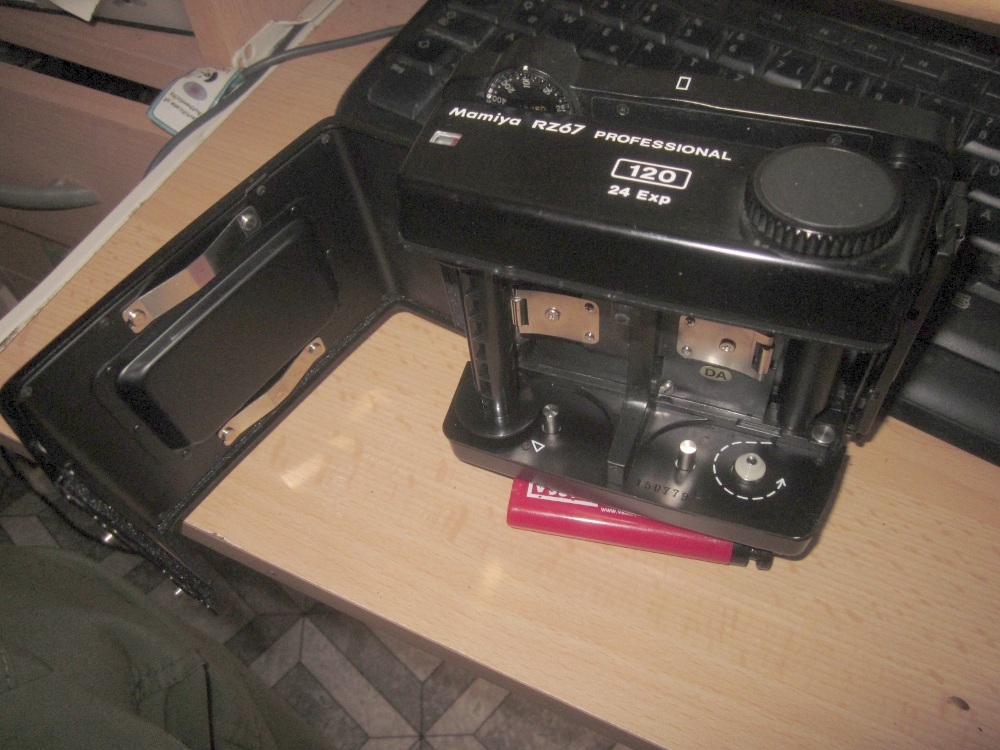

PS: Can you shoot us an image of the 'start point arrow' on the film insert?

Thanks for the maths. I just measured the 'steps' on the wasted film roll again. 28mm. This seems to be the distance the film gets advanced when cocking the shutter, and in theory I can now even define the spacing between the images, and thus image height, myself, or not? Say, if the film gets advanced 28mm every time.. so I could have 24mm height with 4mm spacing, or 22mm with 6mm and so on, depending on how I cut the mask. Would that be correct?
Start point arrow? I assume you mean the marker on the inside, hence I made an image with the back opened. You can even see the serial number (150779), maybe anyone knows some sort of list or so which might help to locate the back in space and time.

OK...the start point isn't unusual.
Make your mask, find the center, make opening in the mask...say, 23 or 24mm.
Shoot a roll of film...see what the actual spacing is between frames...whole roll.
If you think there is enough spacing, you could then enlarge the mask...out another (?) mm's.

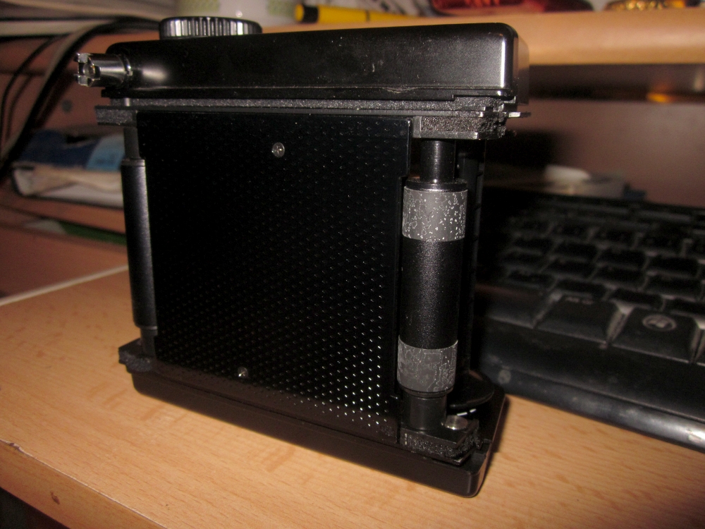

Can you please take a picture of the insert, so that we can see the pressure plate? This is getting very interesting because a number of us who use the RZ system have never seen this particular type of back -- yet it appears to be manufacturer designed based on the labeling. Thanks!

I am noticing (I think) something curious from the pictures. First, as we know, the RZ does not have film masks of the type used by the FUJI 680 system. The film mask is provided by the outer housing of the film back, i.e., the part of the back that includes the ISO dial. OP already has this, as his first picture shows the "120 24 exp" label. Second, any finder mask only affects the user's ease of framing. AFAIK, finder masks have no role in masking light that strikes the film plane. This is what's interesting to me: from the pictures, OP appears to have everything necessary to use the back with proper spacing (although framing when composing shots would be challenging until he masks his focus screen in someway).
My conclusion so far: some prior owner of the back did not realize what they had and tried to "fix" the back but in doing so damaged it and now the spacing is off.
The pressure plate, looks large/normal sized to me (aren't the pressure plates identical for all formats?):
I noticed that there are empty holes for screws, 2 on each side. Maybe this is where the correct (or any other) mask would be / had been attached. My regular 120 back is loaded, so I can't check it on there atm.
