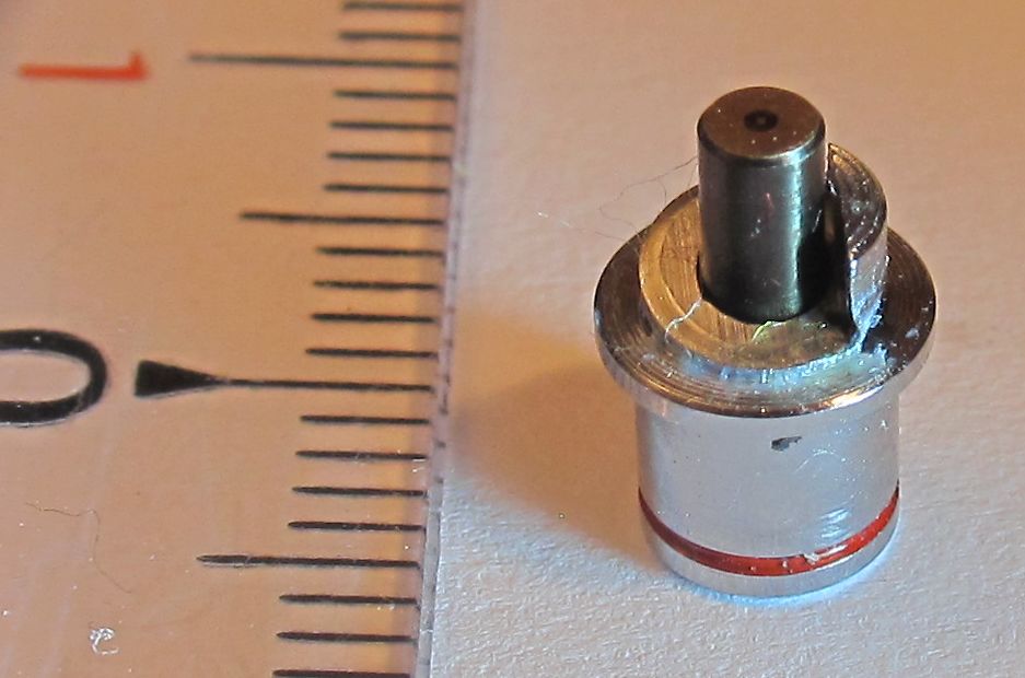

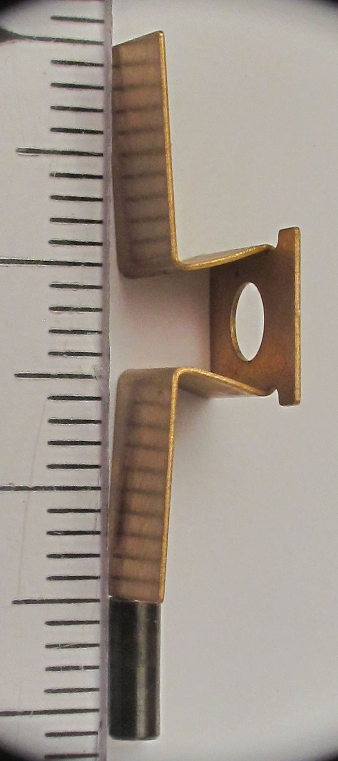

1. unknown coper-item from inside rz67-180mm. 24mm lenght together with cable-release-tube(pin)

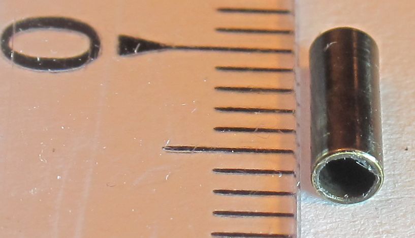

2. cable-release pin(tube) open on one side.

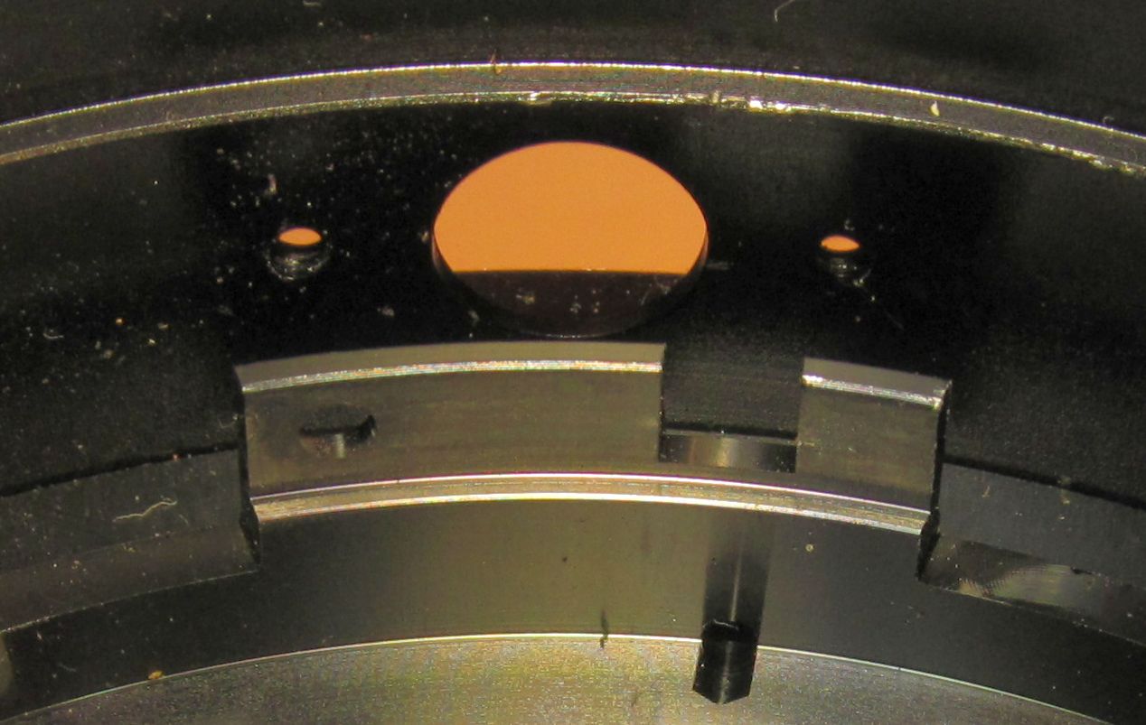

3. situation inside tube with big hole for cable-release-tube
4. cable-release-tube with pin
questions:
1. where to put that copper-omega-shaped part? maybe between hole and wall holding by the two elements(lens and tube)
2. how is cable-releas pin attached so it cannot go off? maybe only when lens is closed.
so remains question 1.
thanks
nb: i didnt open the lens. the parts came off. maybe i did force the mount-ring too much.

Why all this fuss? When i manipulated the lens-yes i know where to trigger to make the aperture work- all of a sudden i had two tubes in my hands.
after succesfully triggering apertures(with a certain combinaton i could not stop down completely) i could neigher attach nor release lens-cap. in the meantime i also wanted to know what function has cable-release when camera is absent..... the all of a sudden when if force- turned the mount-ring i had two tubes in my hands. and most probably that copper-omega-shaped part fell down.
i have found a parts and repair-manual. will consult that later. or if someone can help.
I think the mechanisme how the tubes are joined is not the best i would have chosen. they added slits instead of holes to be able leaving the screws on the other lens-tube.they are accessible trough holes in the tube. one could imagine what will happen when the are losening.

Have found that part in parts list. photobooksonline dot com or on ebay -one must take care of screw M5122-S4411 which is showing a tiny roundshaped item under the screw. thats a white plastic ball. not mentioned seperately wierd. maybe its a combo: screw plus ball.
reconstruction should be easy.
