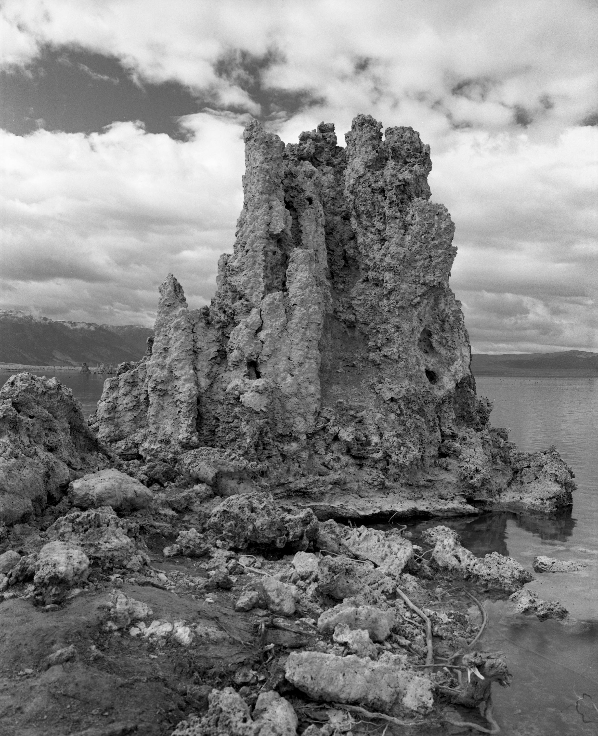

Shot with the 65mm C lens, very sharp with excellent contrast IMO. Tufa towers, Mono Lake California.
