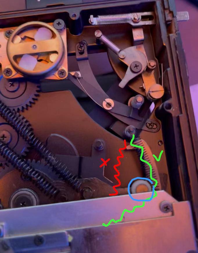

I've bought a very cheap RB67 Pro S and it required some tinkering. I've also encountered terrible focusing issue. It was clear that it's not a focusing screen issue, because i had to tilt it up half a centimeter from it's resting place. It was the mirror not going all the way down.
This problem is not covered in service manual. It was mirror return spring RS2457, that should be routed around a small white plastic roller to actually pull the mirror down, not sideways. Turned out it somehow jumped out of there. Simply routing it back with a pair of tweezers fixed the issue.
