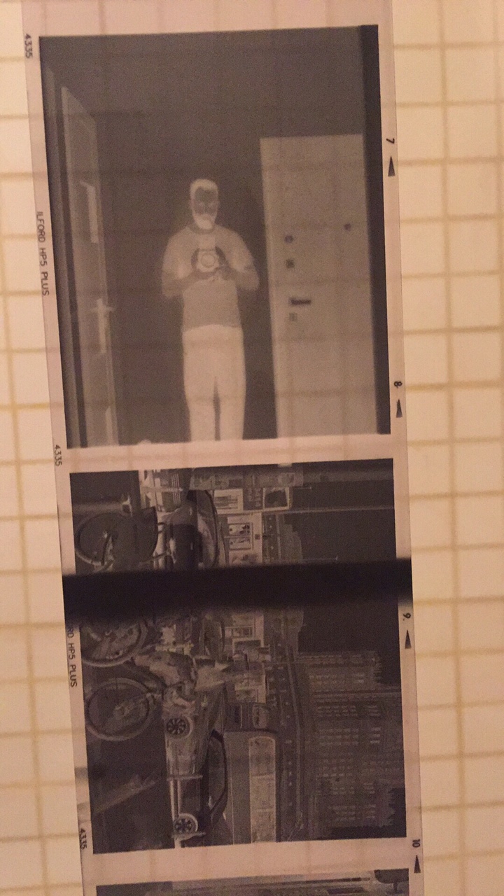

Hi, I don't know if it's OK to join that thread but this is my first post here, so hello everyone.
So, I have some issues with my recently bought Mamiya RB67. Yesterday, I developed my first HP5 roll shot with this camera and unfortunately some overexposed strips occurred.
Maybe someone has an idea what's wrong? Could it be light seals or something else?
First and second frames are OK, rest has black strip.

dreh, looks to me like a dark slide that is leaking light. If it was the mirror it would be 90 degrees to what you are seeing. If it was the revolving back, or film back, it would show a leak coming from the edge of the frame. The leak is in the film back (for example, the dark slide) for sure, because it is across the short side of the film in both portrait and landscape orientations.
The bars being that big n bright, it shouldnt be hard to nail where its leaking.
Its easy enough to do a light leak check. Using a bright light, put your eye to the back of the camera and watch for light inside with the lens closed.. mirror up and mirror down. Then fire the camera a few times to see if the mirror is hanging.
with the lens off, do the same thing again with the film back on n eye in the lens mount. move the light all teh way around the camera n back n see if any light is leaking in.
extend the bellows all the way out, move the light around as you watch for leaks inside. Usually the corners develope leaks.
Dark slide would show much higher up in the negs. BUT I do suspect its your back leaking since your negs show images have the same bar in the same place even when rotating the back... if it were the mirror, that bar wouldn't move with the image. ALSO.. the indorr shot doesnt have the bar... says its gotta be directional as well.
Take a look at the film back face... the plastic film mask... it has alot of screws holding it on. Are any screws missing or lose?The door seals good or look rotted or missing?
It could also be the rotating back seals where teh fiom mag mounts. Are they rotted or missing?
