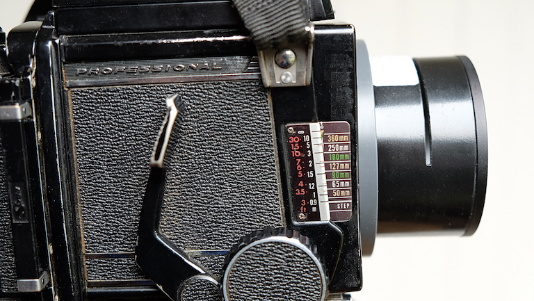

RBs last beyond forever.
They ignore blizzards, hurricanes, and sand storms.
I bought my well used Professional (not even a "Pro" version) in 1976.
Hauled it thru H... & High Water for 41 years with almost no pampering.
Probably shot 20,000+ negatives with it.
Last week I dusted it off for a debut with a new soft focus meniscus lens.
May I present my faithful warrior...
Reinhold
ps: the lens is here...
https://www.photrio.com/forum/index.php?threads/for-mamiya-rb67-wollaston-meniscus-lenses.154129/

Wow that's amazing!! I have a question about the kl lens. There is a focusing tab at the very front but isn't the focusing done via the focusing knob? What's that focusing ring for?

Sean the tab on the 127 and 180 mm lenses is just a depth of field guide. The 50 and 65 mm C lenses have floating element to flatten focus and maybe another lens. I looked on the rb67.helluin.org site and I do not see the 127 and 180mm KL lenses listing a floating element. Hope this helps. EBay has a bunch of RB67 WLF listed for sale last I looked.
Questor84
Sep 21, 2017
16
Cadillac, MI
One more note. The 140 mm C Macro also has has a floating lens. I thought there was another lens.
