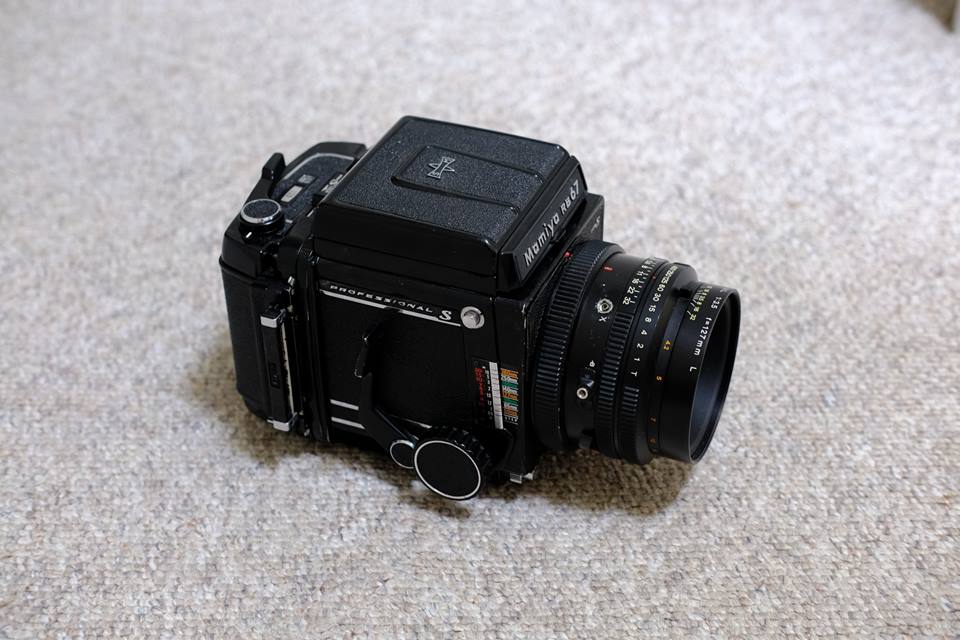

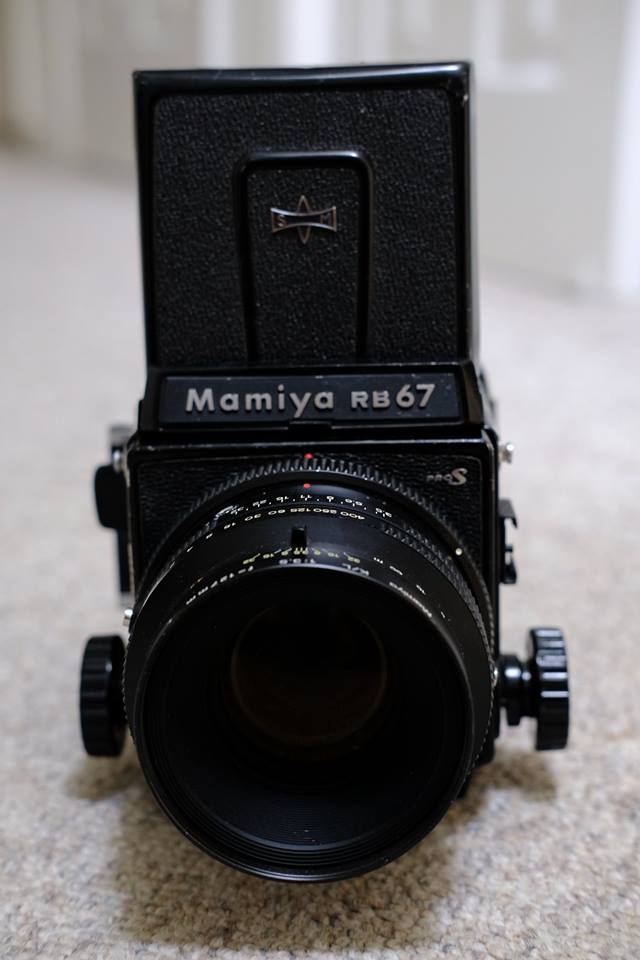

So I have the opportunity to pick up a mamiya rb67 pro-s with WLF, 127mm and 180mm kl lenses, and 3 backs. All in great condition for $300. I've been looking at these for a while but haven't really had a need for one yet. But I feel like this is a great deal that might come around again later if I do decide to get one. I already have a M645 pro as my everyday shooter. Is this a smashing deal and I'd be stupid not to buy it? Thoughts?

If it is all in good condition, then I would say it's a good deal. But the RB67 is a heavy camera, and best used on a tripod. If you frequently hand-hold your 645, it's best if you handle the RB67 before buying if you're not familiar with it.

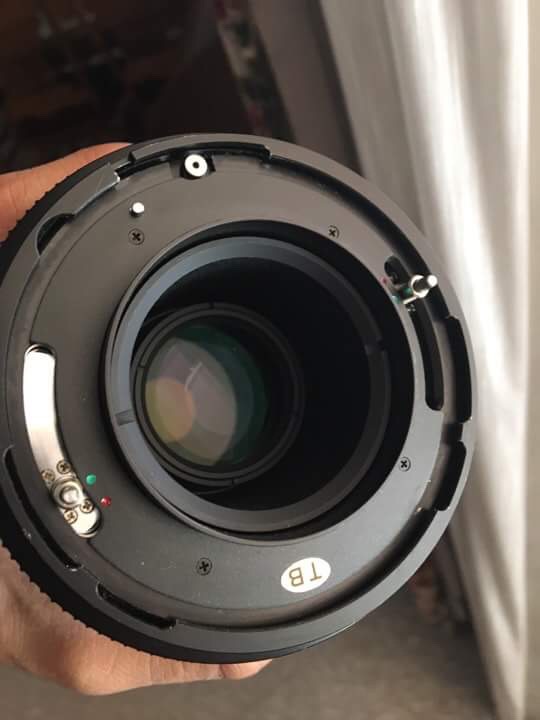

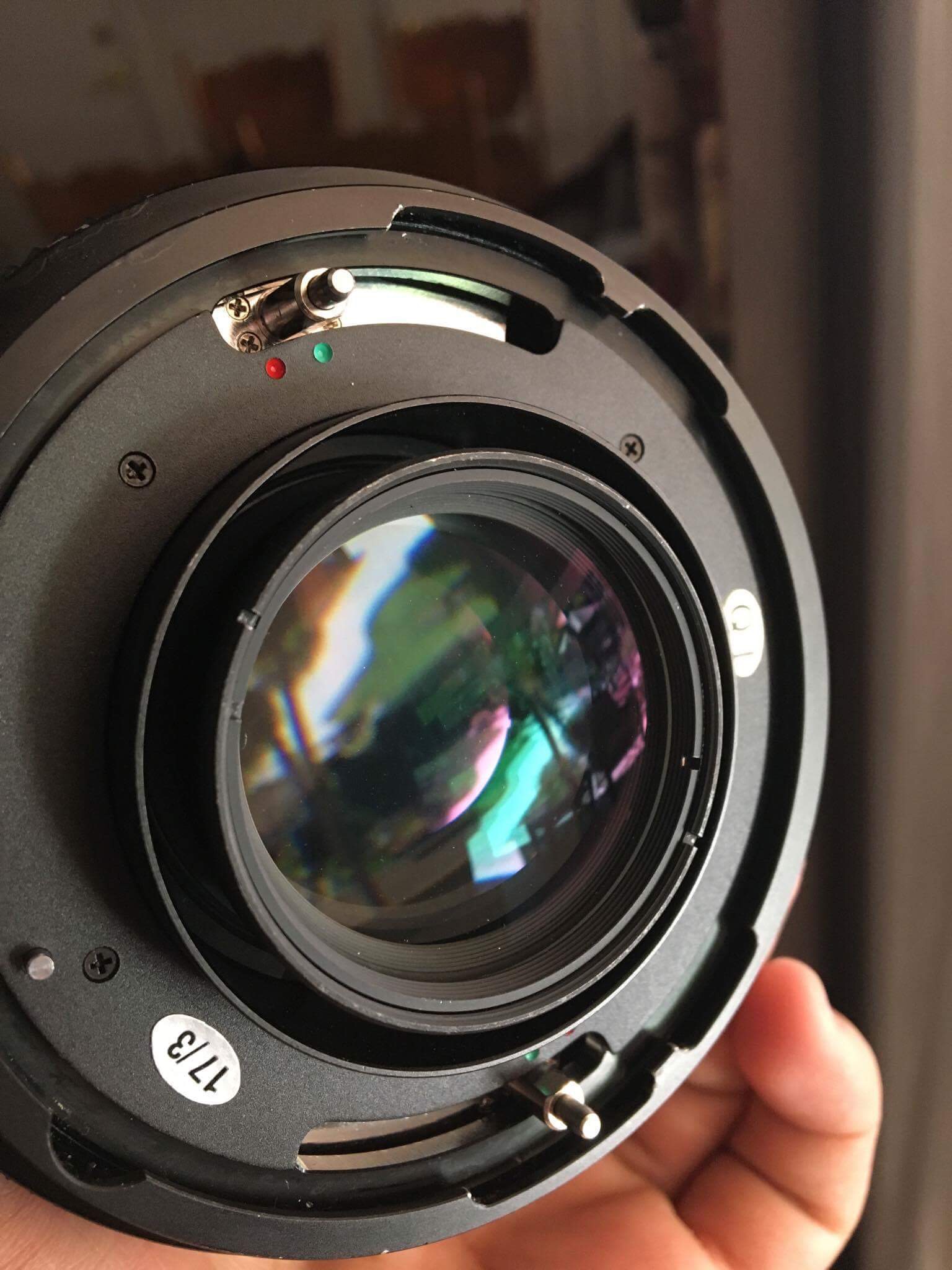

They appear to be in perfect condition

If you've not already done so, familiarize yourself with RB67 Pro S operation,
Dead Link Removed
The lens shutters can be tested off the body. There should be YouTube videos showing this. Basically rotate both pins towards the green dot, then hold down the silver pin while flicking the pins towards the red dot.
However, it's best to test on a body (with back removed) to ensure the timing of the mirror-baffle, shutter, and aperture are correct.
Also, ensure the three backs are Pro S backs. The Pro S has useful interlocks the earlier Pro model did not have, so you want Pro S backs.

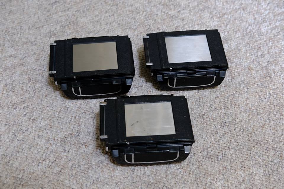

Here's a few more pics of the items. I can't tell if those are Pro S backs or not since I can't see the top. I think the one on the body in that pic is a ProS, I can kinda make that out. The body looks to be in good condition for how old it is.

It's a reasonable deal, if everything works well. The backs are Pro or Pro S, need to see the other side to be sure. They are not Pro SD.
Check the backs for light seals, see if they are disintegrated.
Check the body for proper actuation by firing it 10 or 20 times in succession. The cocking lever should always return to the correct position and the rear "kicker bars" or arms that interface with the film back should not hang.

Oh and the back on camera appears to be Pro S as it has the double exposure lever under film cocking lever. Pro back did not have the double exposure prevention. No lever to allow decision for double exposure or not. And are they 120 backs. There is a difference in pressure plate for 220 Pro S back.

I believe they are all 120 backs but not 100% sure. Guess I'll find out when they get here. He sent me some scans of photos he's taken with it and I don't see any light leak issues, assuming he's telling the truth :D
