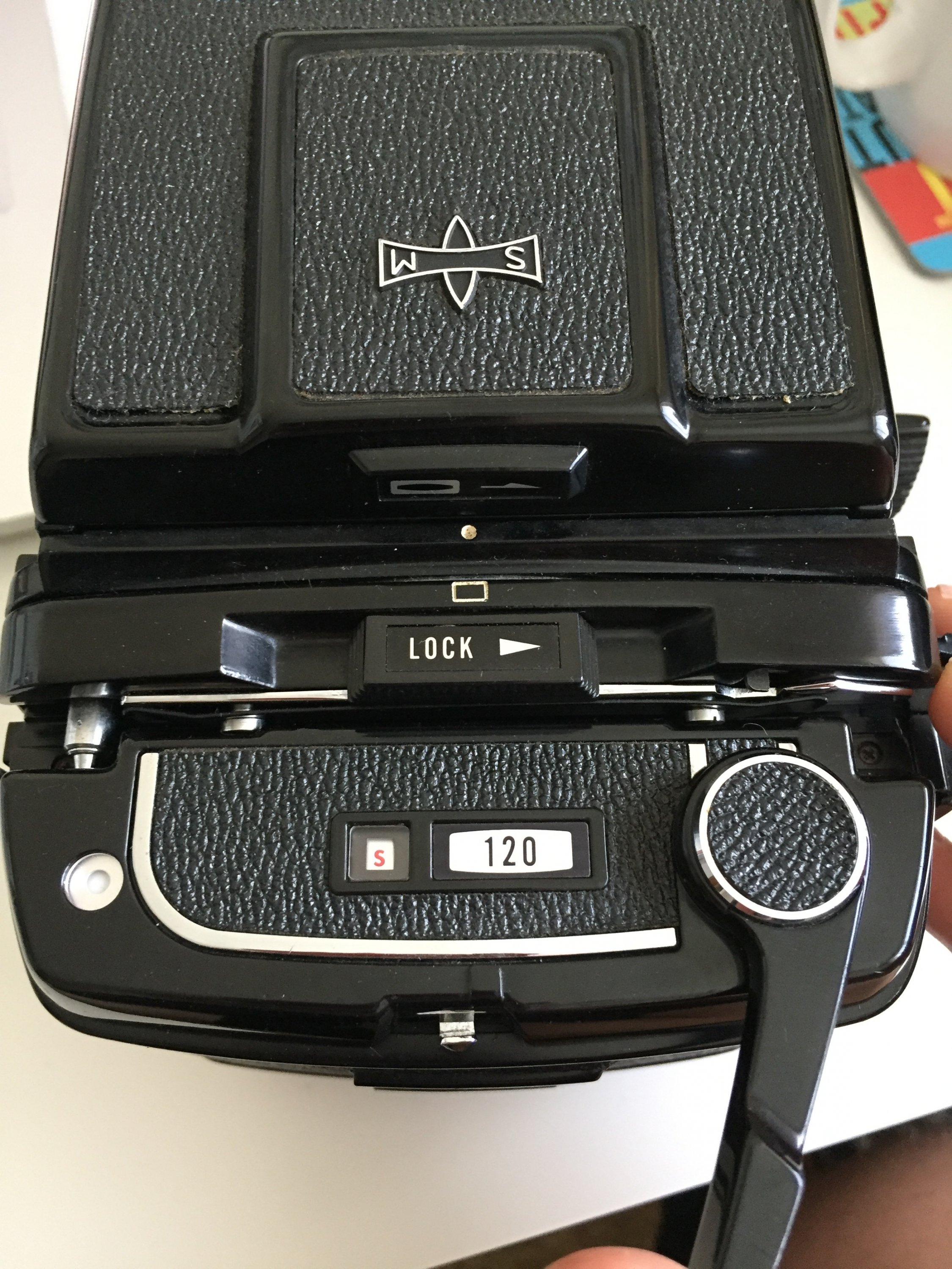

Hello,
I recently purchased a Mamiya RB67 on eBay. I shot a test roll on it and it came out blank. I had a read up on why this could have happened and I ensured that I had the switch on the lens set to N rather than M. I went out and shot a second roll and it has again come out blank...
One thing I have noticed is that every time I take a picture and attempt to advance the film using the winder, I'm not able to until I've moved a small silver lever on the film back (please see attached photo) Is that correct or is there some sort of fault? When shooting the counter goes up with no problems, so I'm a bit perplexed.

Moving the silver lever on that back is normal. Did you remember to pull the dark slide? Some of the old ones didn’t have an interlock, and sometimes it doesn’t work.

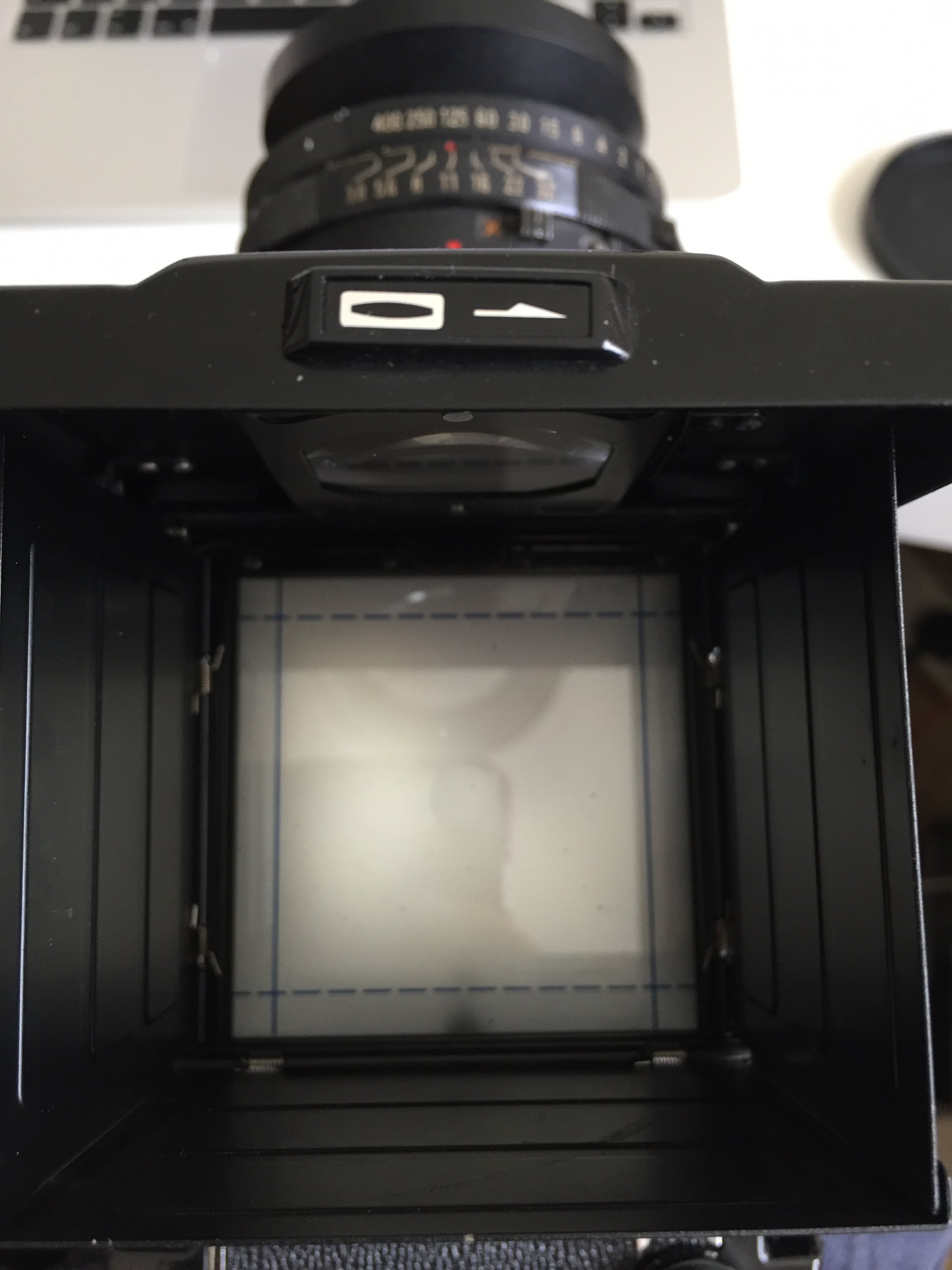

When shooting - and you can do this with no film in the camera - does the viewfinder go black after triggering the shutter? Do you have a second lens to try? You could remove the lens and check to be sure it is cocked correctly. There are articles online about how to do that. Be careful - I don't remember all the details. Look into the lens from the front with the f/stop open. Can you see the shutter open? There's not much that could cause this other than the lens not opening and the mirror not coming up if the darkslide is out.

The view finder looks like this after being triggered (see attached image)
I don't have a second lens to try unfortunately. I haven't removed the lens and checked if the lens is cocked properly, I will look that up to see how to do that.

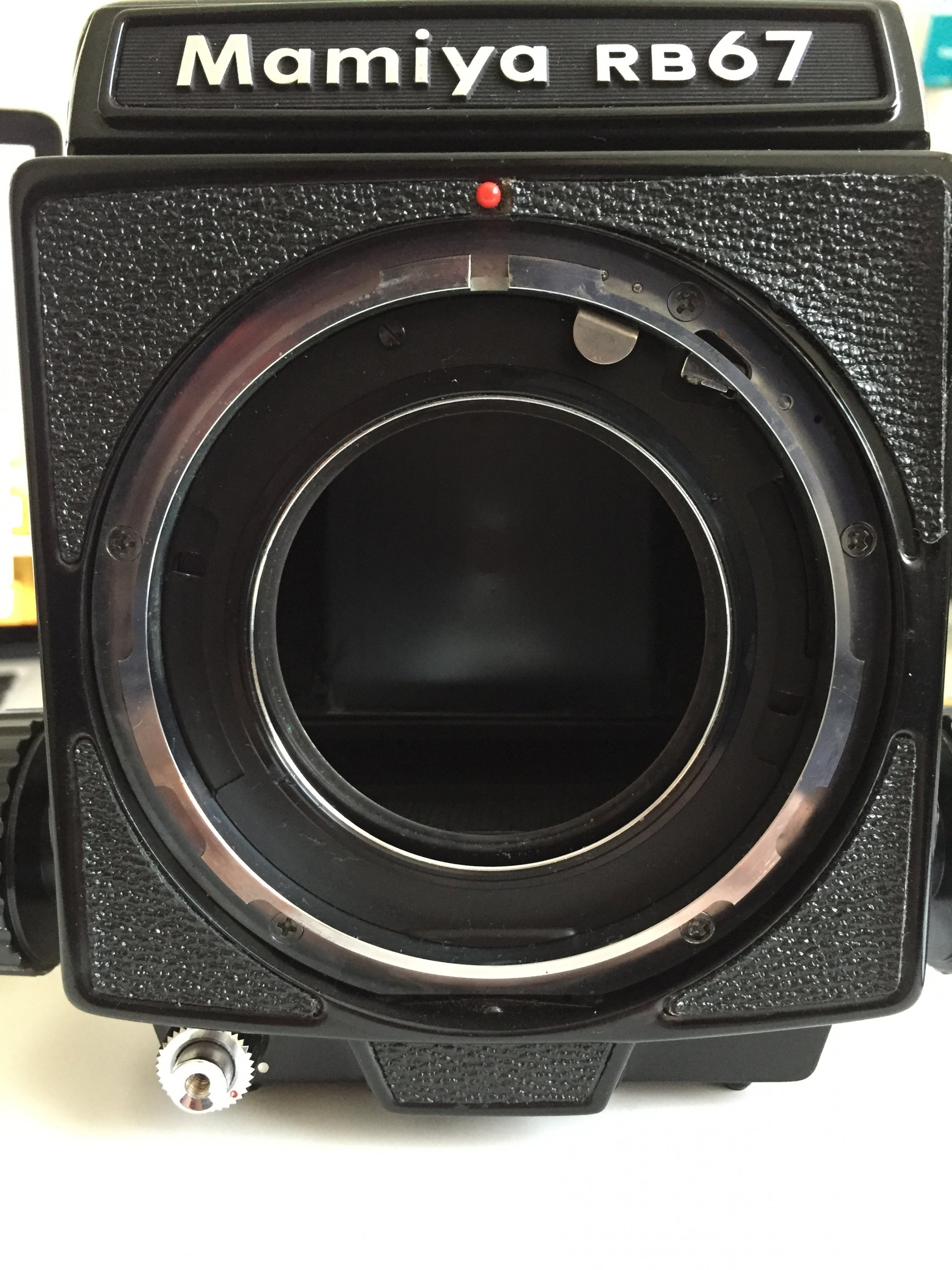

Thats interesting to know. Please find attached photo of the front of the camera with the lens attached.

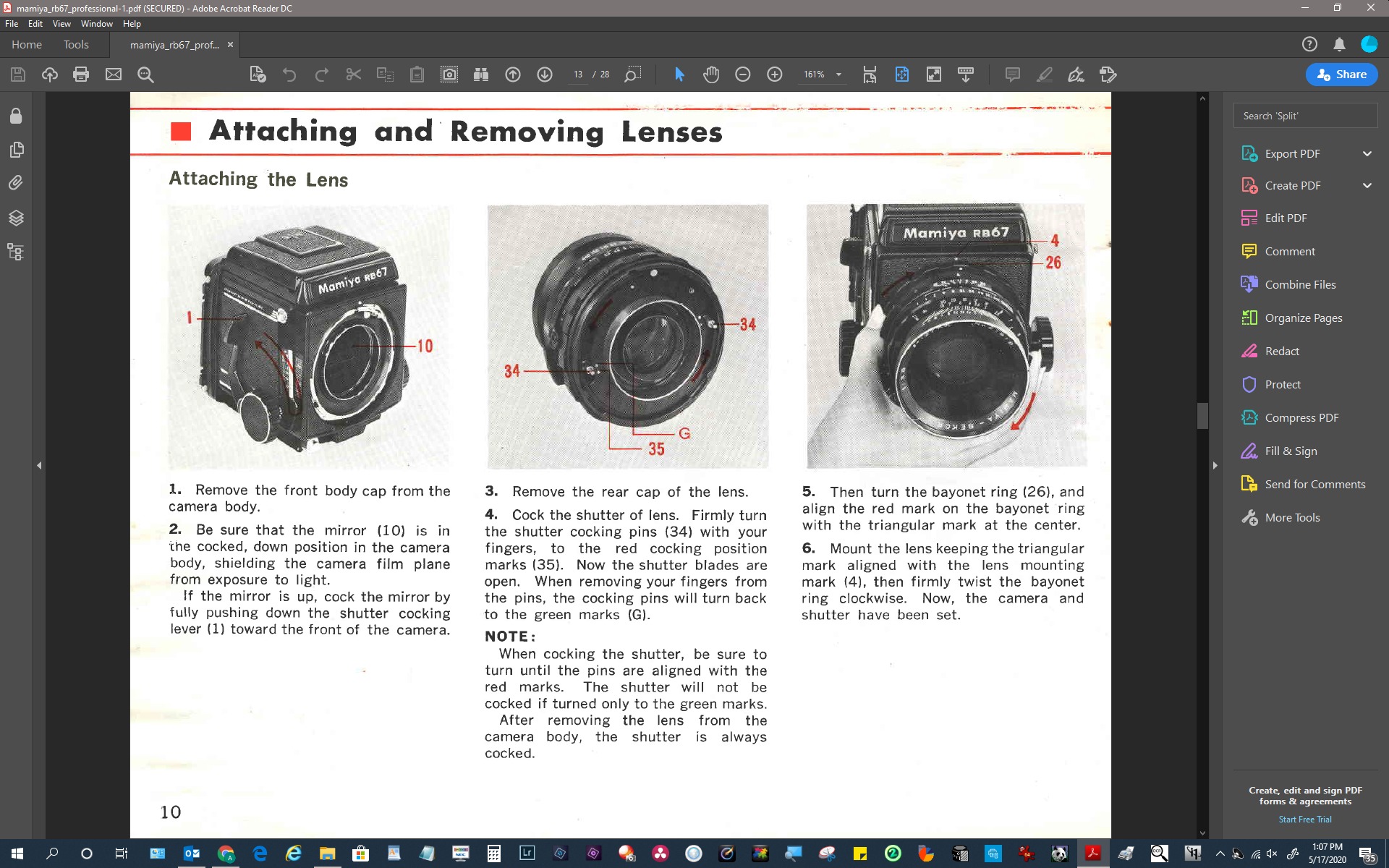

You can verify the lens and its shutter is working off the camera. There are two pins on the end of the lens that attaches to the camera. If you hold both of them and then rotate them you will cock the shutter. Then press the little button near those pins while rotating the pins back the other way, When you reach the end, the shutter will fire if on N. If the lens is on M, just rotate it to N and it will fire. Look through the lens to see if it is working. You can change the shutter speeds to check at all settings.
There is some good service info in the Mamiya manuals which you can download from Butkus. Note that there are different RB67 models so get the right one. https://butkus.org/chinon/mamiya.htm Good luck.

Thanks for your reply. I've just removed the lens and have moved the pins to the red and green dots, but when i push the tiny silver button nothing happens...

You have to manually move the two pins back to where they started while you hold the silver pin. When you reach the original start point, the shutter goes off.
Ok cool i've just done that and the shutter went off with no problems. How do I recock the shutter on the lens, do I just manually move it around to the green and orange dot?

Did you look through the lens and see it open? Did you verify the aperture is moving correctly too? Try a few different settings just to make sure.
To put the lens on the camera, recock it first. Than put the lens on the camera. Here's instructions for RB67.
I am on vacation, so I don’t have mine to compare. The dark circular plate between the two chrome circles needs to be in a specific position when cocked. Maybe someone else can post a photo of a functioning RB to compare.

It appears to me that you have the original model RB67 Pro. That model, and in particular that version of the film backs, does require you to move the silver lever on the back for each shot.
When you look at the negatives, are you able to see edge printing? If not, the problem is with the developing.
