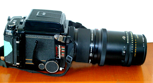

For fun, here is a photo of a sort of facsimile - a 180mm plus 2x teleconverter mounted on an RB67! Guaranteed to intimidate the young children in the room.
