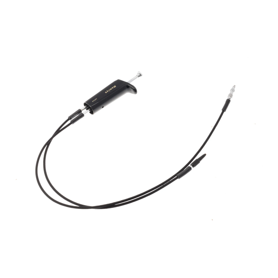

I have an excellent RB67 Pro S kit that works perfectly. But, when I try using a dual cable release with the mirror up setting engaged, it works only intermittently. If use a single cable release attached to the lens, manually trigger the mirror using the shutter release, all works well.
Does anyone have any thoughts or recommendations as to why the dual release does not work properly?
Thanks in advance.
I've never had the Mamiya dual cable, but I understand it to be a sequential release -- push partway to fire the body (close shutter, raise mirror, and stop down aperture to setting), then after a pause push the rest of the way to fire the shutter. If yours isn't working that way, it's likely got dirt or congealed lubricant in the combination housing (between the plunger and the dual cable sheaths).
No, I don't know if there's a way to open it up for cleaning and inspection; unless it's important to you to use the actual Mamiya equipment, a pair of conventional cable releases and some method of making it harder to release them in the wrong order would be a much cheaper solution than sending that one out for repair or trying to find another in better condition.

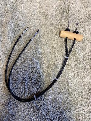

I had the original dual release cable and gave up on it after only a couple outings. Even using the recommended sequence approach and holding my mouth open during mirror up release and closing my mouth on shutter release.
What I did was made my own that I have used for years flawlessly. I took two standard cable releases and mounted the push release ends into a wooden dowel. I just took a short wooden dowel and drilled two holes in it and slid the cables all the way thru up to the point of the release buttons. The release buttons had tapered bottoms at the base that wedged nicely into the dowel tightly. Marked one side of the dowel mirror and the other side shutter. Done deal.
I placed a zip tie at the end of the main release button cable easy to find even in the dark. The other one gets screwed into the mirror up shutter release or N-M on lens barrel. I marked the ends of the dowel with a M & S with a Sharpie.
As I use the release setup for every image it gets a lot of usage.

That’s a great idea. I may give that a try. Thanks!
You're welcome. It has been MANY years since I made this unit up but I think these were the cable releases I used or similar ones. They're definitely 20" releases.
