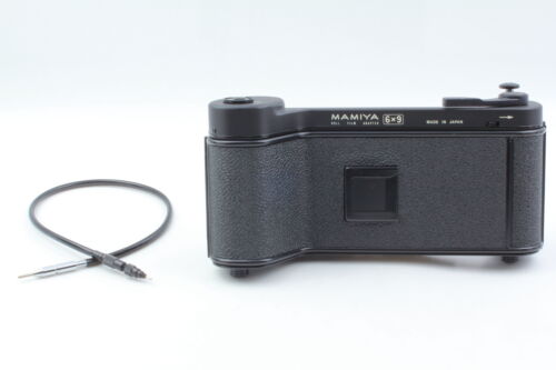

...just come across one for these for sale with but with some problems and missing part? Needing some advice.
There's no means of triggering the camera- the grip has no cable release. The 6x9 magazine has a shutter button, but again no cable.
Are these cables generic or specific to the Press? Also the 100mm lens focusing became stuck when testing - it was very stiff but would turn a bit and then it got completely stuck at min focus distance. CLearly will need service - shutter / glass good. I believe this lens may be collapsible. 50mm lens more useable. Pair of RB backs i don't need. I think the biggest issue is the triggering arrangement and it functions.
100mm may be. Maybe if the price is right. THanks for any useful info
The grip with cable can be found on evil-bay. The focusing helicoid for the 100mm needs servicing, and it may be less costly to just get another lens. Do the rb backs fit it? Some of these cameras were 2x3 graflok and will use rb-67 backs.
Some don't use the shutter rigger on the grip, a plunger type cable release will fit into the lens itself. I have 2 6X9 backs never used the shutter release, not sure if my Mamiya backs have a release, what would the reason for it? There are techs who will service Press lens, if you are good with tools and buy a lens spanner wrench and find the service manual you can try and service the lens yourself. Does shutter speeds seem accurate?
If your roll film back has a shutter button it is a Type 3 back. It is designed to allow you to trigger the lens shutter from the back and not the grip. You will need to find the shutter release cable designed for that back. I checked the auction site and managed to find one Type 3 back that had a cable release so you would know what to look for. If you can't find this cable release then you would have to find a cable release for the grip and use it instead and trigger the lens from the grip.
Mounting backs on the camera - you have two choices - a M Back or a G back. The M back allows you to mount the Mamiya Roll Film Backs and the G Back allows you to mount Graflok backs.
If your lens is the 100mm f3.5 lens make sure that you can extend the lens and that it locks firmly into place when it is extended.
Page 5 and 6 in the attached instructions show the backs and lens information

I'm not sure if you're asking whether the release cable in the grip is specific to the Universal/Press, or how to trigger it if the cable is missing. The lenses all accept a standard cable release. Thus, you could possibly bodge a standard cable release into the grip, or use it without the grip and use a standard release taped to the side of the camera or the film holder (especially if you use it on a tripod, you don't need the grip). There is also a way to trip the shutter with your finger, but it's awkward. Or buy a complete grip.
Be aware that this is like a large format camera - there is no auto shutter cocking or double exposure prevention (except possibly for the rare type 3 film holder that gordrob mentioned).
The lenses sometimes suffer from dried up grease in the focus helical especially if they've sat unused for a long time.
As gordrob mentioned the Universal can accept different M or G back frames that allow use of the Press type film holders or the RB67 type film holders. The Press and Super 23 have non-exchangeable M or G back frames, but the film holders are exchangeable.

The M backs are wonderful. At the same time the are so rigid that you don't need a grip to hold the camera. That's why they made the type 3 back with its release. And yes, the cable is specific. And no, the Polaroid 600 and the Mamiyas are in no way compatible, neither lenses nor backs. On my Instant camera pages there is a page about the Polaroid 600SE and a page about the differences between the backs https://www.instantphoto.eu/diy/uni_600se.htm
Yes, stiff focusing helicals can be a problem with these lenses given the age. I had the focusing helical seize up on a 65mm lens that I owned myself since the mid 90s (so I know it used to work ok, but hadn't used it for a period of years). I was able to free it up by working a little bit of solvent/light oil into the helical from the rear, and storing it in a warm place for a long time. Full overhaul is desirable for focusing helicals, but I find re-assembling helicals to be very difficult, so I try to avoid it at all costs.

It seems that few people here realize that the "Model 3" film back has ITS OWN proprietary cable release that is completely different from the standard GRIP cable release. Combined with the Model 3 back it provides a shutter interlock which prevents double exposures.
I, too, am trying to find one of these Model 3 back, proprietary cable releases for sale. I was frustrated when I received my latest film back purchase only to find that it didn't come with the cable release.
I guess that is understandable as you might have a few Model 3 backs but only require the one cable release.
Again... this is a completely DIFFERENT cable than the standard grip cable.
Neil, did you happen to find one? Is there a item number for this specific cable release?

I wanted to add some clarification about the cable release on the Mamiya Type III / 6×9 roll film back, because this caused me quite a bit of confusion and doesn’t seem to be clearly documented.
The cocking/advance mechanism on the back will not operate unless film is loaded. I used a test/exposed roll to confirm correct operation while troubleshooting.
The hole under the trigger button on the roll film back is not a threaded cable socket. Inside that hole there is a small retaining lever/spring clip. If you gently move that lever aside, you can slide in a normal mechanical cable release (like the one used on the Mamiya left-hand grip). When you let the lever return, it clamps the cable housing in place. No special threaded cable is required.
In my case, I was using the left-hand grip cable to trigger the lens shutter as well, and I found that the inner wire was slightly too long. The shutter would fire but wouldn’t fully return, leaving the diaphragm closed. Trimming a small amount from the inner wire fixed the issue completely — shutter fires and resets correctly, and the back works as intended.
Hope it helps!
