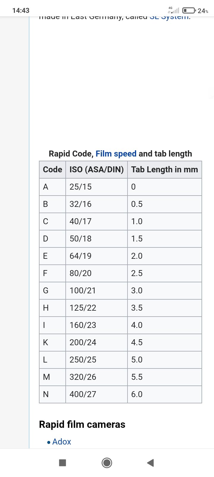

Hi I just found a Mamiya Myrapid camera in fair condition. The selenium light meter appears to be working properly. I wanted to ask if anyone can help me find a copy, even in digital format, PDF, of the machine's user manual. I searched online for a long time without success. I hope someone can help me. Thank you
Sorry, no manual, but here's all you need to know. You'll find out if the meter is OK with a couple of sample shots -- and if it does, keep the camera in the dark when not in use. If it's not accurate, try tests adjusting the ISO -- of course that means using different Rapid cassettes, or modifying the ones you have.

The Myrapid I found seems fine as far as light metering goes. I haven't used film yet. The only magazine I have is marked E and therefore from what I found online it should be recognized by the machine as a 64 ASA. I'm looking for magazines that can use and recognize 125 or 200 ASA film. If I can't find them I will try to change the thickness on the charger to vary the sensitivity. In any case, I would be happy to find a copy of the instruction manual and it seems strange to me that no one has published it until now. Maybe I should try looking for an original copy in Japanese.
