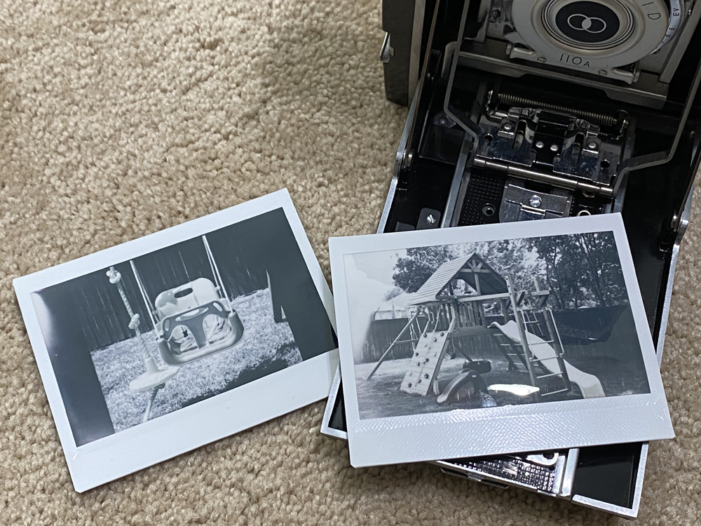

Yup, xya is right. The last step of keeping the camera in the dark is optional. I remove the camera and turnon/fire the shutter to eject the frame covering the lens so no light hits film again.
here's two Instax Wides I shot in peel apart holders in a Mamiya RZ and pack film back modified Polaroid 110a (for sale). :wink:
