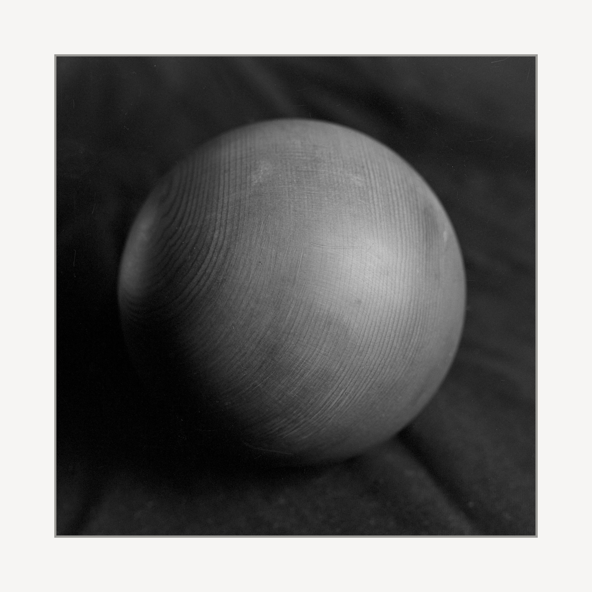

Hi Graham, if you're there. My C330 single exposure back and holder (Model two/type D sheath) arrived and I did a test with X-ray film. While I was very happy with the results, I found the cutting of the film difficult with a paper guillotine (the holder is really fussy!) and lost a few sheets inside the camera when trying to return the "dark slide" to its position in the holder. The English manual mentions a special film cutter (although that may have been for the Type J sheath). Have you ever come across one of these and how do you go about cutting your film?
I'll paste my two test shots below. Film was Fujifilm UM-MA and developer was D76H:
