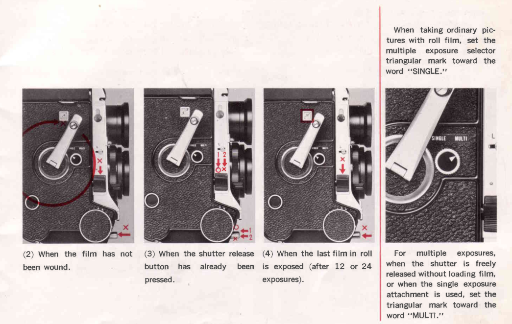

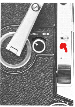

Flip the switch on the side to multi and see if the shutter button trips the shutter. You need to make sure the cocking lever of the lens is under the cocking arm of the camera - and the shutter release of the lens is under the shutter pin on the camera. I don't think the camera will release the button unless the film is advanced to a number or the dial is set to multi. And there is a shutter lock sliding switch on the side of the camera (just in front of the single/multi dial).

There is a shutter lock on the side of the camera.

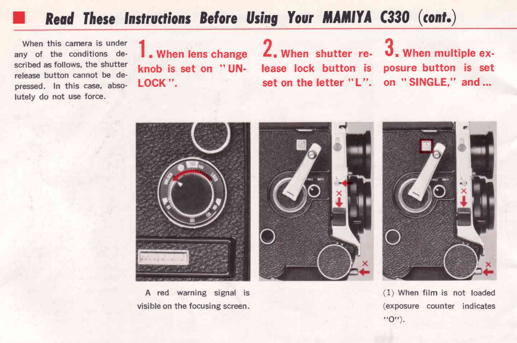

The manual has an excellent 2-page spread that outlines all the conditions under which the shutter button will not work:
I have an actual copy but the above is from Butkus.
