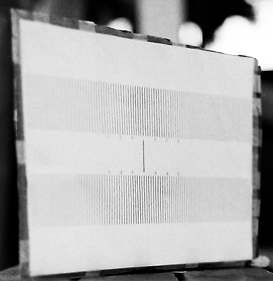

So I have repeated the focus test using this focus test chart at distances between 24cm and 2m. In summary I think my results are much better than before.
The chart is really only good to about 1.2m as it is too hard to accurately see and focus on the thin vertical lines after that.

Finally comprehensive success with fixing and calibrating my Mamiya C330f focus !
Finally I have achieved comprehensive success with fixing and calibrating my Mamiya C330's focus !
I took the long and hard path when a few different decisions earlier on would have seen this solved months ago. Here is my advice for anybody attempting to fix/calibrate their TLR's focus.
  1. Use a focus test chart for close up checking. i.e. distances that have the chart fill at least 2/3 of the viewing frame, preferably much more.
  2. Ensure the test chart is 45degrees, but most importantly ensure the lines and paper chart are as close to vertical as possible using a small spirit level.
  3. When using the test chart ensure the camera's lenses are vertical using a spirit level.
  4. You will quickly see if the camera's lenses do not focus exactly on the test chart's centre line. Use this fact to align the viewing and taking lenses much more quickly than by trying to continually toggle the focus. (perhaps using a split screen focus screen would have helped here, but I didn't have one).
  5. When testing the focus at other distances, you have two reliable options
    1. Use a set of vernier callipers to compare the distance your lens plane extends from the camera's body when focusing through the view screen and then at the film plane. If you don't have a split screen focus then vernier callipers are SOOO much more repeatable compared to trying to focus on a flat image and remembering how in/out of focus the prior view was, OR
    2. Find something like a picket fence or a brick wall that runs away from you at an angle and place a marker next to one picket or vertical mortar line and do comparative focusing on that.
  6. When focus testing at infinity, use one of two methods
    1. A set of vernier callipers as above, OR
    2. The back sighting method (or a collimator if you have one!) to check/calibrate your camera. Fortunately in my case when it was in cal. close up, it was also in cal at infinity.
  7. When you have finished using a ground glass/perspex sheet+magic tape at the film plane, run through a roll of film. Take shots of the focus screen at close distances, then for any further objects up to infinity choose any object with good amount of detail/local contrast and take 3 shots. One in focus, one with the focus slightly too close, one with the focus slightly too far. Then using a loupe and a light box, you can compare the three negatives for sharpness.
  8. Know what tolerances you are aiming for. In my case I wanted at least 0.1mm repeatability since my Depth of Focus was only about 0.25mm. My callipers had a resolution of 0.01mm. When you focus on a line and measure the bellows extension with the callipers then re-focus your manual adjustment of the focus knob, you will not give better than a +/- 0.1mm repeatability.
In another post to this thread I will write about the problems I encountered and what I would have done earlier on to get a faster solution.
Here is a sample focus chart showing my success:
48532-mamiya-c330-focusing-imag1181_focus_test_chart.jpg.att

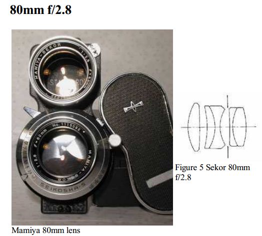

Nodda, thanks for your reply. As an experienced LENS DESIGNER, I was wondering if you could quantify the shift in the focal plane when stopping down from f2.8 to f8 in the lens used which is described below. i.e., by how much will the focal plane shift (in mm). This lens' smallest depth of focus (When focussed at infinity) is about 0.25mm.
The lens is a Mamiya Sekor 80mm f2.8. It is a 5 element 3 group design based on the Cook Triplet. (taken from here and Dead Link Removed)
Peter,
The reason i pitch for not calibrating the center at wide open aperture is not only for compensating for focus shift at the center, but for taking into account the curvature of the focusing field (which if i recall correctly it will also change with aperture), so you get even (read: high performance) resolution at the center AND corners.
If Nodda is a lens designer i'm sure he will be able to explain this in depth.
PS: The 80/2.8 is not really based on the triplet but on the Leitz Elmar 90/2.8 configuration.
