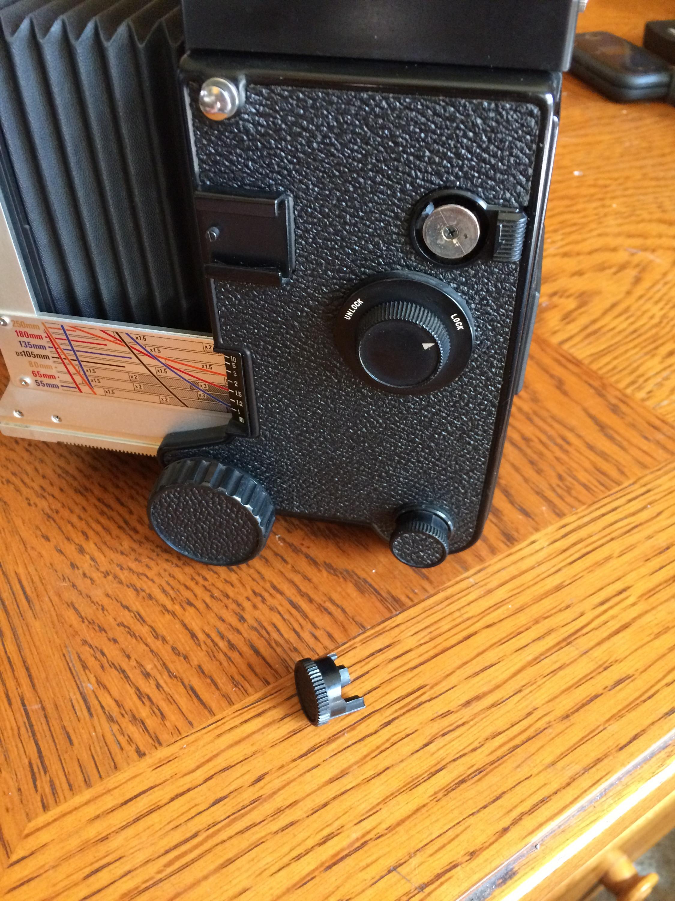

I just received the c220f today that i bought on ebay listed as "excellent condition".. When i opened the package i noticed that the knob to open the back was broken off and laying in the box! And also when i try to focus close up the bellows draw the the rail and lens back into the camera.. Can i replace the knob? Is there something im missing that is causing the bellows to draw back into the camera?
Thank you.

Possibly broken in shipment. Suggest you seek releif from the shipper.

Im waiting to hear back from the seller. I want to keep the camera because it has the latest 80mm blue dot lens in mint condition on it. Im hoping to get some moisture back in the bellows because i think its very dry and thats causing the bellows to retract. Im sure i can make a tool of some kind to pop open the back but i would prefer to find a knob for it if its still available.

The focus should rack in and out without slippage, and stay where you leave it. There is potential for adjustment, but...
The C220f uses the same spool stud release for the back as the C330s. It is damn hard to work around it. I have heard of people doing a replacement, but it depends what the damage is, and whether you want to mess around.
'Blue dot' refers to the last series of the Seiko shutter. In theory there are parts for those around, while the older black Seikos may need cannibalized parts. Mind you, a lot of shutters are no longer in production, and have exceeded the planned parts support period.
Since the glass can be swapped easily, and a touch of blue paint can look like the enamel, a description won't mean a lot.

There is no slippage. Its like the bellows are so tight that they start to pull the rails back in when fully extended. I can deal with the spool and back release and im hoping to get some moisture back into the bellows. The lens is the last 80mm they made and it in mint condition without a single speck of dust in it and the all shutter speeds are spot on so in the worst cast i can just put the lens on another body.
